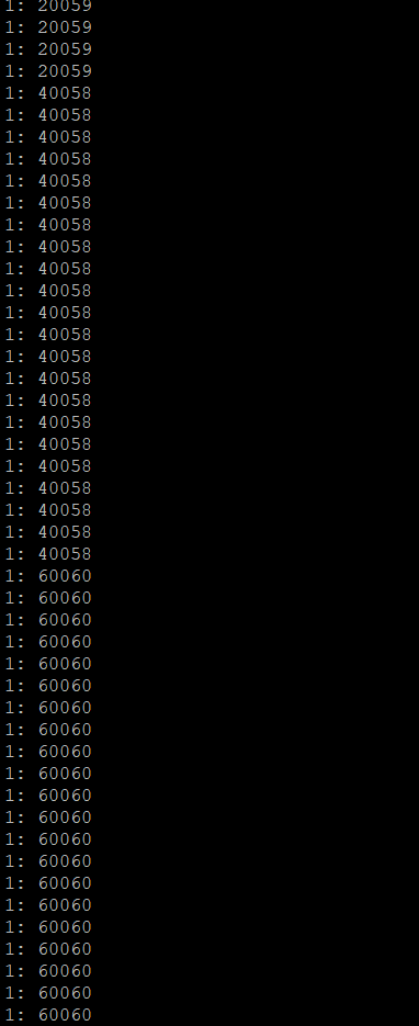

And here is my output: (it should be something between 1000 and 2000):

if ((TIM3->CCER & TIM_CCER_CC2P >> 5) == 0)
This does not do what you think it does. The >> operator has a higher precedence than & operator. Therefore it actually checks the CC1E bit. To enforce the required precedence, you have to use parentheses. And it is strongly recommended to always use parentheses in non-obvious cases.
https://en.cppreference.com/w/c/language/operator_precedence
But in this case you don't need that shifting at all because it doesn't matter which particular bit is non-zero.
if (Receiver_1 < 0)
	Receiver_1 += 0xFFFF;
For this to be correct, the variable type has to be a signed 32-bit integer and the added constant must be 0x10000. But this code is also unnecessary, because C's (and CPU's) modular arithmetic does it for you with a single subtraction.
And toggling with XOR... The code in my previous post is fully correct, much more effective and simpler.
