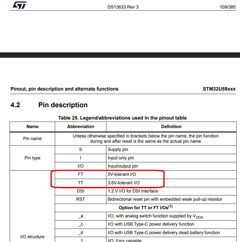

What is the differences between TT and FT mode for usb pins PA12&PA11 in STM32U595?
Yang Yang
Hello, ST expert
For GPIO structure, what are the differences between FT and TT mode? Are there any differences for the ESD diode and the other diode in these two modes?
BR
Yang
5 REPLIES 5
Andrew Neil
https://www.st.com/resource/en/datasheet/stm32u595zi.pdf#page=110
via: https://www.st.com/en/microcontrollers-microprocessors/stm32u595zi.html
Hello, Neil

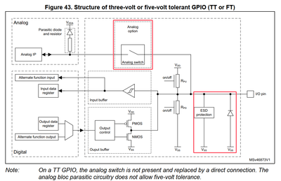

I know what FT and TT means. The question is what are the differences in the GPIO structure in these two modes? e.g. the state of analog switch in the graph? or any other difference?

Hi @Yang Yang
TT pins have clamping diodes to VDD limiting voltage tolerance to VDD + 0.3V. However, FT can tolerate 5V in input/open drain mode without internal pull-up/pull-down.

Hello, FBL
Does that mean there are not any differences about the internal ESD diode and the other diode(circled in the first graph) in these two modes?
But I didn't know that you know!
The graphic you posted says that there is no analogue switch in TT
