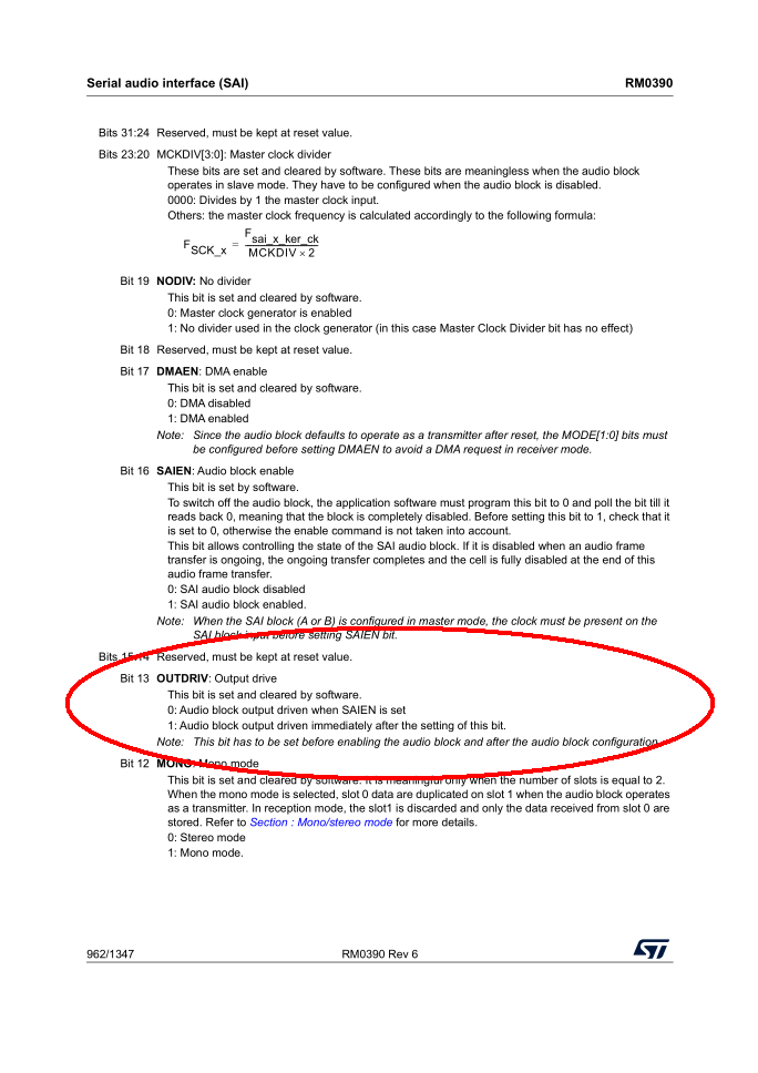

On the STM32 SAI peripheral, there's a member of the SAI_InitTypeDef which is:
  uint32_t OutputDrive;         /*!< Specifies when SAI Block outputs are driven.
                                     This parameter can be a value of @ref SAI_Block_Output_Drive
                                     @note This value has to be set before enabling the audio block
                                           but after the audio block configuration. */
However, I can't find any docs on what that means or does anywhere on the documentation or even on Google. Could someone help me understand it?
Thanks
waclawek.jan
Which STM32?
Cube is open source, so you find out what things do simply by looking into it.
Assuming you use e.g. 'F446, look into STM32F4xx_HAL_Driver/Src/stm32f4xx_hal_sai.c to find out what happens with the OutputDrive field:
 hsai->Instance->CR1 |= (hsai->Init.AudioMode | hsai->Init.Protocol |          \
                         hsai->Init.DataSize | hsai->Init.FirstBit |          \
                         ckstr_bits | syncen_bits |                            \
                         hsai->Init.MonoStereoMode | hsai->Init.OutputDrive |  \
                         hsai->Init.NoDivider | (hsai->Init.Mckdiv << 20U));
Okay, so it's planly ORed together with other struct fields into SAIx_CR1.
Then look into the respective header, what are it's values.
#defineSAI_OUTPUTDRIVE_ENABLE ((uint32_t)SAI_xCR1_OUTDRIV)
#defineSAI_OUTPUTDRIVE_DISABLE0x00000000U
Okay, so it's basically just one bit, SAI_xCR1_OUTDRIV. So now look into the RM:
So this bit determines, that if SAI is set as Master, whether the respective SAIx_SD_x pin should be output all the time (if OUTDRIV = 1), or if it should go to high-impedance state whenever the respective SAIEN = 0 i.e. the given SAI block is disabled.
