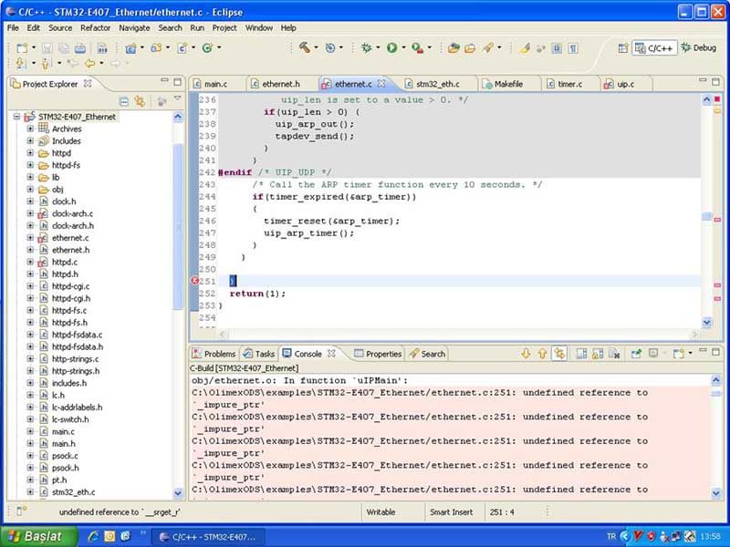

hello forum
I am trying to compile a C program for STM32F4 microcontroller
with Eclipse + yagarto compiler
I get the error;
undefined reference to `_impure_ptr'
there is no function ''impure_ptr'' in whole project
the error pointer points to a line containing only     }

Andrew Neil
Posted on November 22, 2012 at 22:34
''undefined reference to `_impure_ptr'''
Where, exactly, do you get that?
Show the code.
''there is no function 'impure_ptr' in whole project''
Why do you think it's a function?
mehmet.karakaya
Posted on November 23, 2012 at 13:12
hello , here is a screenshot
I searched google - it says this error is related to newlib or something like that
however I couldnot find any answer how to solve this problem

Posted on November 23, 2012 at 16:12
The linker is driven by the LD and LDFLAGS lines, fix those.
