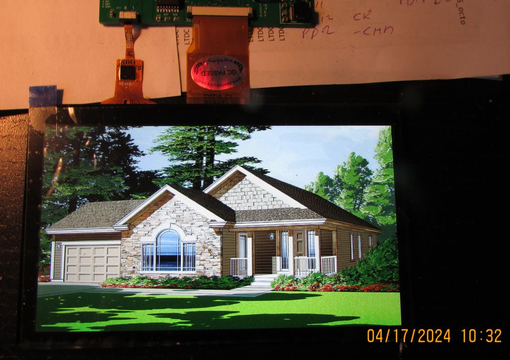

thanks again for the redesigned external loader for OCTOSPI for
STM32H7A3IIT6Q
MX25LM51245GMI00
I got this working finally but I had to create the BIN file in CubeIDE. You need BIN file, it does not load the external loader without it.
And again this OCTOSPI did not want to work in CubeIDE despite copy all the code from working Keil. But I have it working in Keil
So I loaded the external loader and BIN using CubeProgrammer, then I could read from 0x90000000

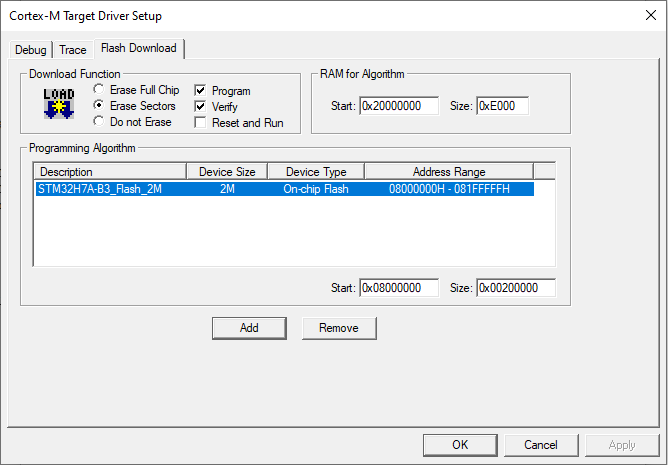

then I went to  Keil, I could not find a place to show me the loader , Keil shows that it is loading at 0x80000000 but I guess it must go to 0x90000000;
but it loads now more data I can see for the first time full screen 1024x600 (before I could load smaller pictures only )
it is really fast the picture is on instantaneous after turning the power on.
Keil enumerates the .FLM it finds in C:\KEIL\ARM\FLASH and perhaps others pathed to the Packs per the device / board instance.
C:\Keil5xx\Arm\Packs\Keil\STM32U5xx_DFP\2.2.0\CMSIS\Flash\MX25LM51245G_STM32U599J-DK.FLM
Names shorter than 31 characters, and fit in the allocated RAM.

From the Keil H7 pack, The H7B3I-EVAL rebuilt with your pin options
https://github.com/cturvey/stm32extldr/blob/main/h7_mx25lm51245g/MX25LM51245G_STM32H7A3I-MNAPI.flm
thanks I am still working on this I try to follow the AN333 from Keil.

I cannot get it working in Keil, it keeps saying , it cannot erase flash. I tried to follow all the setting from AN333.
Maybe I am missing few lines of code in main.c but I do not think I missed anything after reading AN333 from Arms/Keil
Also trying to make my own external flash loader in Keil does not work, I am getting error trying to build the project.
