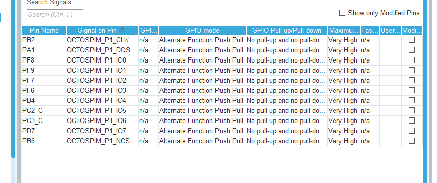

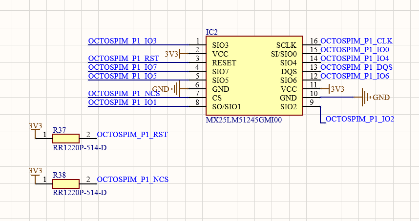

What is your pin configuration? The same as the DISCO board?

not exactly the same pins numbers but it is connected OCTOSPI1, on disco board to OCTOPSPI2, the same memory chip.
