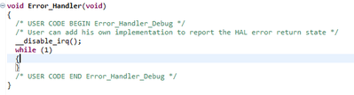

Where does Error_Handler get called? Look at the call stack and go back to see where/why it's called and correct. Step through the functions to see where it bails out.
Thank you for your reply
it is called here ”
if (HAL_OSPI_Command(&hospi1, &sCommand, HAL_OSPI_TIMEOUT_DEFAULT_VALUE) != HAL_OK) { Error_Handler();
Except that normally, if it's written properly, it's not supposed to call Error_Handler.
I don't understand why it can't write.
Step into that function and step line by line and see where it exits. Don't treat it as a black box. Probably something in the sCommand structure is invalid or hospi1 state is not as expected.
nous entrons dans la fonction et elle reste bloquée dans la boucle while(1) :
Savez-vous comment je peux savoir d’où vient l’erreur ?
I'm sorry, I'm just starting out and I don't speak English very well.
