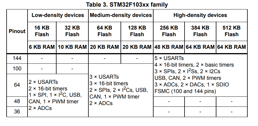

what does the datasheet mean ? This is the STM32F103C8's datasheet.
In Medium-density devices has 1xPWM timer and 3x16bit timers.
i know that 16bit timer can be PWM function.
What is the difference between 16bit timer and PWM timer?
STM32F103C8 timer has timer 1�?timer 2 ...timer 14, this is not 14*timer but 3*timer.
why?

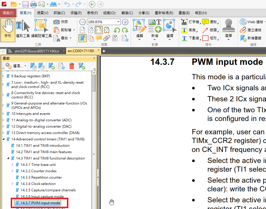

Read the PWM timer definition in the Reference Manual.
Maybe it's the old name for Advanced Timer? (triple PWM for brushless motor control)

If the timer (TIM6, TIM7) has no input or output pins then there's no way to capture PWM input of drive a device with a PWM output. PWM capability is wasted.
ST also likes to include SysTick as a timer, even though it is really a very basic timer, no pins associated with it.
Basic 16-bit timers generally have very specific uses for internal timing, so PWM isn't included.
