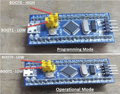

sarvesh
 I am using stlinkv2 just check the jumper position it will solve the issue
