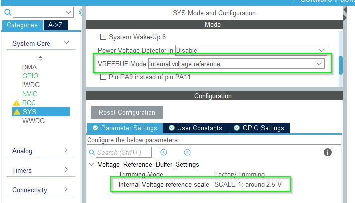

But, is it still possible to use the internal voltage reference buffer which has the option of selecting 2.5 V or 2.048 V like stated in "RM0444 - 17.2 VREFBUF functional description"?
The reason that I'm asking is that I can't find the setting for this in CubeMX for package STM32G071GBUxN.
For package STM32G071RBTx, which are the device used on the Nucleo-G071RB board, this setting can be found on the in CubeMX where in SystemCore->SYS you can select "VREFBUF Mode" and select "Internal voltage reference":
0693W00000UFPHCQA5.pngWhere after, it is possible to select the desired "Internal Voltage reference scale".
Therefore: Is the internal voltage reference available on devices without VREF+ pin?
If yes: Is this setting available somewhere in CubeMX?

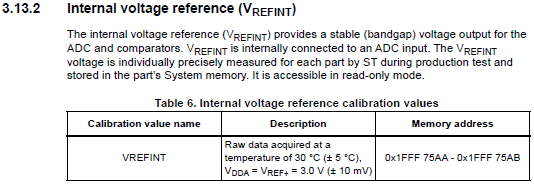

According to the STM32G071x datasheet p.25:
0693W00000UnVi2QAF.pngThen I assume that I should be able to correct the my measurements using this value.
The value saved in my device on my Nucleo-G071RB fetched from memory address 0x1FFF75AA are:
0x67B (1659)

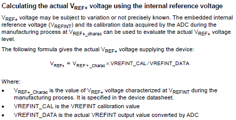

Then; from RM0444 p.378 we have:
0693W00000UnVjoQAF.pngWhen I get the ADC value from VREFINT (ADC_ch13) I get: 0x62F (1583).
Then, using the formula above:
VREF+ = VREF+_Charac × VREFINT_CAL �?� VREFINT_DATA = 3.0V x 1659 / 1583 = 3.144V
But when I measure the Supply/Reference voltage of the Nucleo board it is 3.306V
That is a deviation of (3.306-3.144)*100/3.306 = 4.9%.
I were hoping for more precision.
Am I misunderstanding something here?
BR Miguel

Did you perform ADC calibration as outlined by Calibration (ADCAL) subchapter of ADC chapter in RM, before taking the measurement?
FwMaker
Thanks @Community member​ :thumbs_up:
That was just what I needed. With the offset calibration and use of the factory stored calibration data, then the deviation is only 0.054%!!!
