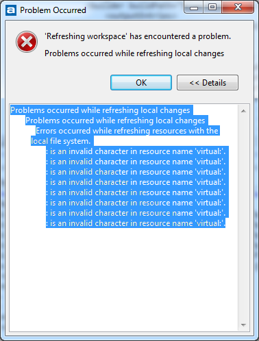

There is another issue as well. I created a project using links (root folder checkbox unchecked), and brought it up into TrueStudio. I was able to build the project fine. I then regenerated the code in Cube without making any changes, while the project was open in TrueStudio, and I get the following dialog box in TrueStudio after the files update due to the code regeneration. I can close the dialog box and build the project OK, but I'm not sure why the box pops up.

Dear user,
these issues will be fixed in next release 4.15. Thank you.
