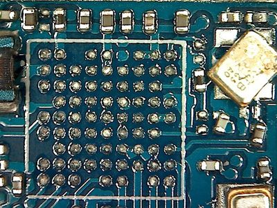

Hello everyone,
I'm trying to set up VREFBUF as an internal reference at 2.5V, but the configuration isn't working. I've seen there were issues with this (VREFBUF Enable Problem - STMicroelectronics Community), but even after rearranging the function 'HAL_SYSCFG_VREFBUF_HighImpedanceConfig(SYSCFG_VREFBUF_HIGH_IMPEDANCE_DISABLE);', it doesn't work properly. I'm using the STM32WLE5JC on the 'Lora E5 mini' development board. Here is my code:

2023-11-23 12:54 AM - edited 2023-11-23 12:55 AM
I just realized that in the Lora E5 chip the Vref+ pin is connected to Vadd pin, so that's the problem, it's not possible to use VREFBUF in this chip. In case anyone face the same problem I left here the internal connections of the STM32WLE5JC.
