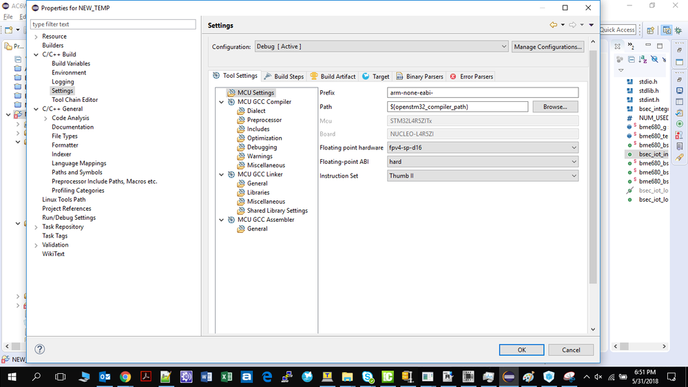

When I compile the STM32L4R5ZI BME680 libary, I got the error message of use VFP register arguments,
Can anyone let me know how to fix inside the AC6 SW workbench?

-mfloat-abi=soft -mfpu=fpv4-sp-d16 -L worked and got build but

You'd need to determine the settings for the FPU used in the library
-mfpu=fpv4-sp-d16 -mfloat-abi=hard
If hard doesn't match, try the soft ABI setting, or NOT using the FPU
‎2018-05-31 8:24 AM
It's complaining it is mis-matched, work through the FPU setting options if you can't tell from inspecting the library
‎2018-05-31 8:32 AM
Try different combinations of the float configuration flags
-msoft-float
-mfloat-abi={soft,softfp}
