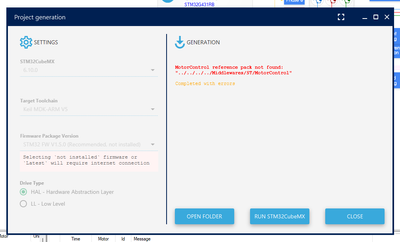

2024-01-28 18:57:20,083 ERROR [LineInfo_to_exitCode.manage_MCPackNotFound] MotorControl reference pack not found: "../../../../Middlewares/ST/MotorControl"
What's the problem? do you have any Idea what's wrong?

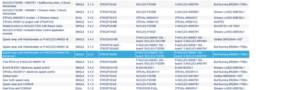

Here the steps that I have done,
1- I opened the "MotorControl Workbench 5.4.8" and selected some random example project, in this case speed ramp with Potentiometer on P-NUCLEO-IHM001 kit-- Advanced
2- I hit save as project and saved that in an empty folder named motorControl in win11 desktop
3- from the tools menu I clicked the generate button
4- in the opened dialog, I choose target tool chain to be keil v5 and I hit Update,
5- I would get this nasty error
Please check the attached pictures,

Hello @ali_dehbidi,
Could you check whether you have a wb2mx.properties file in your .st_motor_control folder located in your home directory ?
If it is the case, please remove it (or comment all the content)
Last remark, I highly encourage you to switch to MCSDK 6.2.1. The potentiometer example is now a built-in feature, no need to start from a custom example.

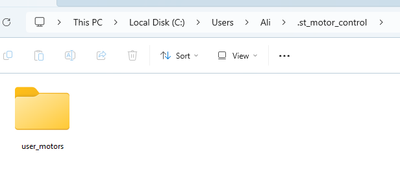

Where is home directory located in win11? what folder should I check?
 you can see all the files that are in the .exe file of MotorControl Workbench 5.4.8
I have the same problem with MCSDK 6.2.1 too, also I see that in the MCSDK 6.2.1 the MCU selection is very limited, is there any plans for supporting more MCU's?
cedric H
You home directory is in your C:\Users\ folder, It should contain a directory named as your login name.
Inside this directory you should have a .st_motor_control directory containing a wb2mx.properties file.

thanks for the update, Please see my home folder content
There is no wb2mx.properties file, so the problem with V 5.4 remains, also v5.4 gives a lot more MCU selection, are you sure the new version would support 380 MCUs?
