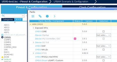

Did you select (what you want) in Cube ? (as in my pic... cmsis core + dsp -> as lib )

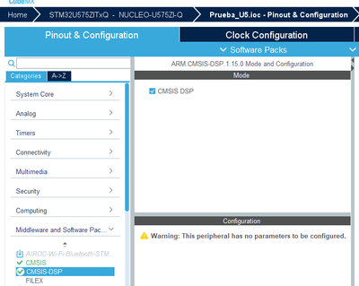

Yes.
I have selected it:
It gives me the options "Source" and "Not Selected".
Then I also have selected the two middlewares in the CubeMX:

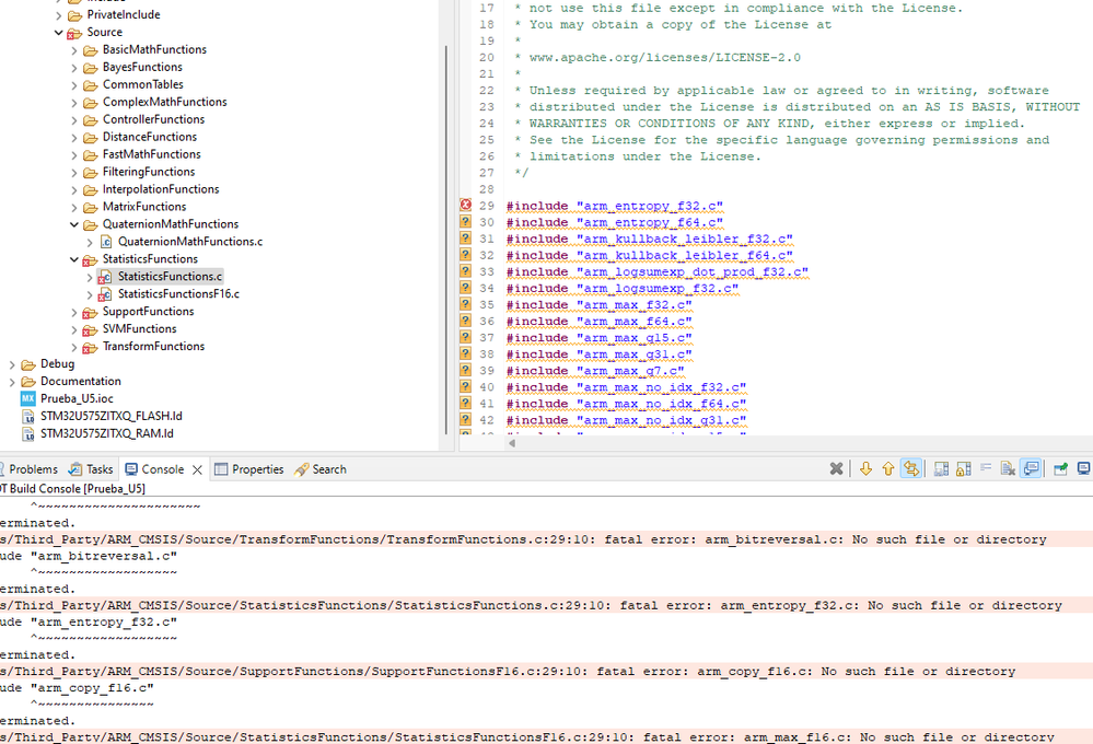

I generate the code form CubeMx and open In in CubeIDE  and try to build it as is without any modification and some source files belonging to the CMSIS/DSP middeleware give me some comepile errors, for example:
"StatisticsFunctions.c"
These files are provided by ARM/ST , they should compile and work properly.

1) The Compile Issues I was having were related to the source files with capital letters of the  ARM_CMSIS/Source/Subfolder_xxx that are added to the project when including the ARM_CMSIS_DSP middleware  to the proyect with CubeMX  i.e ( FilteringFunctions.c )
  Such files only contain a list of  #include that try to include other .c files
  ( i.e: "arm_biquad_cascade_df1_32x64_init_q31.c" )  and when you try to build the project you get compile error "No such file or directory".
2) To fix this error I had to manually Import the "Source" folder from my STM32Cube Repository for the STM32U5
 "STM32Cube\Repository\STM32Cube_FW_U5_V1.4.0\Drivers\CMSIS\DSP\Source" which contains all the source files that theses files like "FilteringFunction.c" try to include.
3) Once I replaces the "Source" folder this way I got a different copile error which stated that the functions like for example "arm_biquad_cascade_df1_f32" where already defined in another file.
4) To fix this error I had to comment out all the content from the capital letters starting files like "FilteringFunctions.c" so that in my main file when I include "arm_math.h" and call any mathematic function like "arm_biquad_cascade_df1_f32" the source code of such functions is linked to the definitions that are made in the individual files for each functions linke "arm_biquad_cascade_df1_f32.c" that are present inside the "Source" folder that I manually have imported into the project.
5) To resume the "Source" folder created by CubeMX when adding the ARM_CMSIS_DSP middleware to the project is useless and has to be replaced with the one in the "STM32Cube\Repository\STM32Cube_FW_U5_V1.4.0\Drivers\CMSIS\DSP\Source" excluding all the files that start with capital letters in every subfolder.
