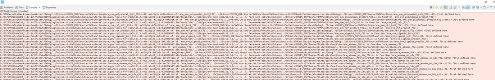

I am trying to use the newest cmsis dsp library (v1.15) to implement a vector matrix implementation. I am running into a "first defined here error" when trying to build with the cmsis dsp library (v1.15). I created an empty project just to try out building a project with the library included. I am running into the same issue there.

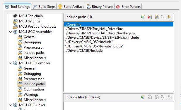

If I understand correctly, CMSIS v 1.15 does not have a "lib" folder anymore like the older versions and only the Include, PrivateInclude and Source folders must be integrated. Therefore the instructions in Configuring DSP libraries on STM32CubeIDE - STMicroelectronics Community are not helpful to me.
Here you can see the folders I included.
Am I missing something? How can I use the newest CMSIS library? I couldn't find any helpful documentation on the internet.

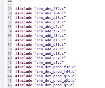

Doing so results in a multiple definition error. The reason for this is, that the subfolders of "Source" have a ".c" file beginning with a capital letter (in the "BasicMathFunctions" folder it is "BasicMathFunctions.c" and BasicMathFunctionsF16.c").
These files include ".c" files causing the multiple definition error on my system.
Excluding these ".c" files from my build fixed my issue. Solved: Re: Error including the CMSIS include files in the... - STMicroelectronics Community describes a similar problem to mine.

The DSP folder must contain the include folders. Then add a new path in order to support header file as already described in Configuring DSP libraries on STM32CubeIDE - STMicroelectronics Community section 2. Including the DSP libraries and header files.
For that please remove "Source folder" in your project.
Please let me know if the issue is solved!

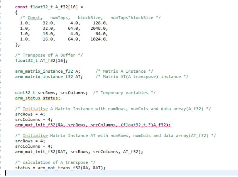

When I remove the "Source" folder, the project compiles without errors. As soon as I am using functions included in the arm_math.h I get an "undefined reference" error.
Here is the code in my main function.
A new path ist added to support the header files (as shown in my original post).
In the link you posted, there is a ".a" library file added. The lib folder is not available in the new cmsis version. I am not sure what "library" you mean, that I am supposed to include. This is the version I am trying to use ARM-software/CMSIS-DSP: CMSIS-DSP embedded compute library for Cortex-M and Cortex-A (github.com)
From my understanding, reading the documentation I thought the source folder is needed to compile the project.
Unfortunately, I cannot attach my project to this post. I uploaded it to wetransfer. You can view it with the following link: https://we.tl/t-6zw8hxkEY1

Building the project works and using functions such as "arm_mat_trans_f32" work when using the headerfiles of the newest CMSIS version.
I tried to implement the vector matrix multiplication, that I intended to use the updated library for, as these functions are not included in older versions of CMSIS. When compiling I get a "undefined reference to 'arm_mat_vec_mult_f32' " error.
I have the assumption, that the library file in <STM32Cube_Repository>\STM32Cube_FW_H7_V.1.11.1\Drivers\CMSIS is of an older CMSIS version, that does not include vector matrix functions.

I'd add that this applies to all source folders. If you're using MatrixFunctions for example. Comment out the contents of MatrixFunctions.c and MatrixFunctionsF16.c
