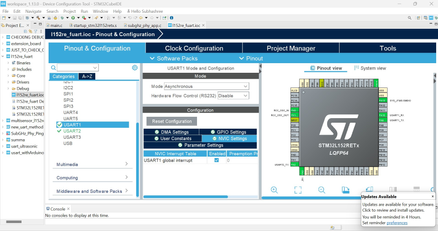

I am able to transmit data from STM32WL to Arduino UNO board using USART Serial communication but on following the same procedure I am not able to transmit the data from STM32L152RE to Arduino board though baud rate matches and the code and circuit connections are fine.
This is how I configured the port.

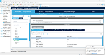

Could you provide the USART setting of the Arduino?
Do the settings match those of the NUCLEO?

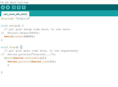

And the following is my Arduino code (I used the same code which worked for STM32WL)

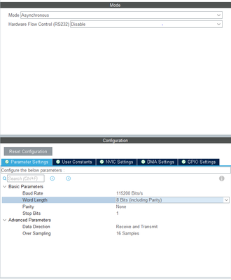

Hello @Subha_shree_bask ,
We don't know about other Arduino UART settings: parity, word length etc..
As you already succeeded to communicate with STM32WL, are you sure you had set the same UART parameters for STM32L152 device as for STM32WL? i.e. parity, word length etc ?

Yes mam I am using the same Arduino code as I used for the STM32WL board, Also the parity and word length I did not the fix anything its a default parameter in the Arduino IDE. Only there is an option to select the baud rate in the IDE.

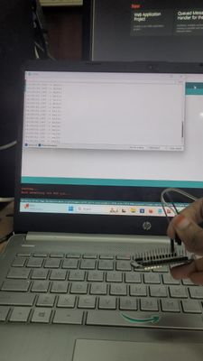

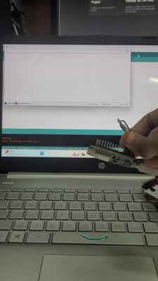

Yes the STM Code is fine because I tried the same lines for STM32WL55 board, and instead of Arduino UNO I tried with ESP8266 NodeMCU it works fine.
And I used the same code for STM32L152RE code and connected the STM board with ESP8266, which uses 3.3V logic. When the RX and TX lines are connected with the ESP8266 there is no Serial output it is just stuck
but when I remove the RX and TX wires the output is printed that it received when it was connected.
Again when I am connecting the wires the serial monitor is stuck. I tried using a different Serial Monitor the result is the same. So I guess from STM32L152 board the string is getting transmitted.
