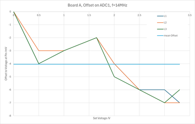

I've been struggling with the ADC of a STM32G474QE on a custom board for some while now. I initially saw a discrepancy between an onboard NTC thermocouple and its measured ADC value. The measured Value (calculated to mV) was off by an average of 50mV over three boards. The impedance of the NTC circuit is reasonable low with 500ohm, which should result in no issues with this rather infrequent measurement with a a high sampling time.
I then started seeing more of that behavior with other ADCs and their respective channels. There was always some offset in the measurement. To be able to quantify the offset, I ran a test, where i applied a dc voltage to the other channels, measured the voltage at the pin and compared it to the ADC values. (see attachment meas offset.png). I had very similar behavior on several boards.
I then looked into ways to compensate this and started to implement measurements to Vrefint as injected samples after rerunning the ADC-calibration. (I always ran the calibration at startup, but was cautious about unstable supply voltage at that stage). And what I've found was, that using __LL_ADC_CALC_VREFANALOG_VOLTAGE, each board had a calculated VREF voltage ~100mV lower then the supplied 3.3V. From the previous measurement series, I took an average offset and came to the conclusion, that those ~100mV was closer to 37mV but simply scaled by 3.3V/1.2V = 2.75.

So to conclude, my ADCs reading are always off by an average off 37mV across three boards. Is this to be expected with a specified accuracy of 6.9 LSB (100 mV in my case)? https://www.st.com/resource/en/datasheet/stm32g474cb.pdf p. 143 Any ideas what can be done to compensate more of the false readings?

Hi Igor,
to test, I left out the calibration and it did have an effect. Instead of 3.182V Vref+ calculated from Vrefint, I now had 3.387V. There is a similar behavior over the measuring series as bevor, but with an added offset. That is expected afaik, the calibration only accounts for the factory offset, no gain adjustments. See attached graphs. Note that I changed fADC and sampling time additionally. From 42MHz 24.5 cycles to 14.2MHz 247.5 cycles for testing. The out of spec offset at @ 1V remains.
On that point, the calibration seems to correct the ADCs value from 65 to 100 points on ADC1. With less pronounced changes on ADC2.
Difference in the ground potential should not be an issue since in these measurements the internal OPAMP are used as signal source in a standalone configuration. For the measurement I compared its output to the ADC, so any influence will not be present. The line to the ADCs input is pretty long thought, so adding a capacitor or increasing sampling time helps compensate this issue.
@MasterT
Thanks for your input. The capacitors and differential mode are both viable considerations we look into for the next iteration. For now, lowering the frequency also helped. The values for each channel on ADC1 are closer to each other (except at the problematic 1V measuring range).

In my latest measurement series I had a bug with the initialization of the ADCs, especially the clock division in the common ADC structure and didn't set the division for ADC1 and ADC2.
Fixing that solves the issue of the offset! I ran each channel on the ADC1 from 24.5 to 247.5 cycles, which doesn't have an effect. So its not really the sampling time, but the silicon around the SAR that benefits from the lower clock.
Thanks for your help.
