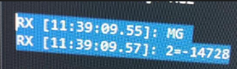

Hi, I'm having a problem with unintentionally splitting a message I'm trying to send over the UART using DMA . I am using one function to send the message:

Not every message is split, moreover 99% of messages are sent without any problems, but sometimes messages are split into two parts and I don't see the dependency when this happens. I don't use RTOS.

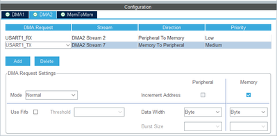

I'm using this DMA only for this UART, but also for TX and RX, at first I thought the RX stream was interrupting the TX stream, but I set the TX stream priority to DMA_PRIORITY_MEDIUM where RX has DMA_PRIORITY_LOW and that didn't help.

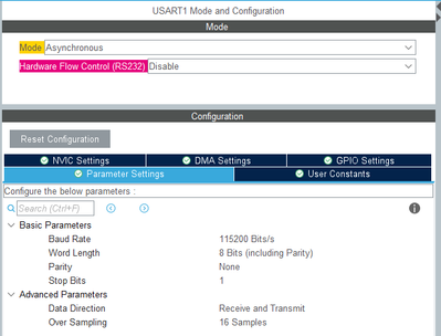

UART and DMA configuration:
Examples of splitting messages:
Unfortunately, I have no idea what can cause the fact that the significant majority of messages are sent correctly, but some are sent incorrectly. If you have any ideas, please help me with this issue.

But when you wait for HAL_UART_TxCpltCallback , Message4 already has been loaded with the new message.
The DMA will be merrily transmitting the 'old' contents of Message4 and your code overwrites it part way through then waits for DMA to compelte. Sometimes the DMA will be part way through transmitting it, sometimes not.

looks like you calling sprintf( Message4 ...) while Message4 is still being sent out by DMA.
suggest you wait for DMA to complete before loading the next msg into Message4

Oki, so I understand that I should wait for the HAL_UART_TxCpltCallback not only before sending, but also before the sprintf() function?
You should check the was_u1_tx_cplt flag before sprintf and set it to false after sprintf and then start Tx with DMA. When the Tx is complete, the flag is set again in the callback.
Is it actually splitting it? Or is this how your receiver times out, buffers, or granularity/resolution there.
Check signals on a scope or logic analyzer.
Expect to have to reconstruct data, and resync, on the host. If there are no additional characters inserted, I'd look at other expectations and synchronization
