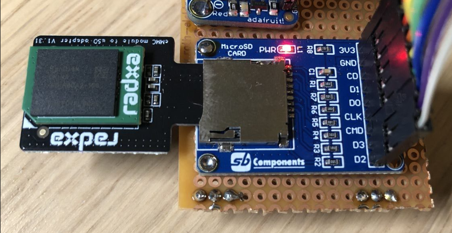

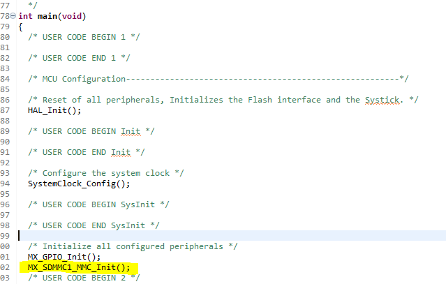

I have started a small journey to try to get started with eMMC memory and are trying to get it working.The end goal is to have a USB HS mass storage device eMMC working with a file system. (32gb or more)

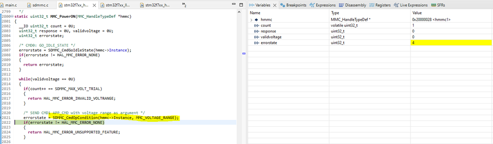

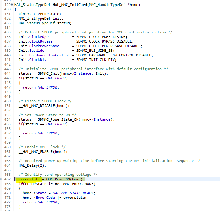

My current step that I'm stuck is where the "MX_SDMMC1_MMC_Init" fails.
Specifically to get the eMMC voltage level fails.
/* SEND CMD1 APP_CMD with voltage range as argument */
I have some theories what can be wrong but any help would be really useful :)

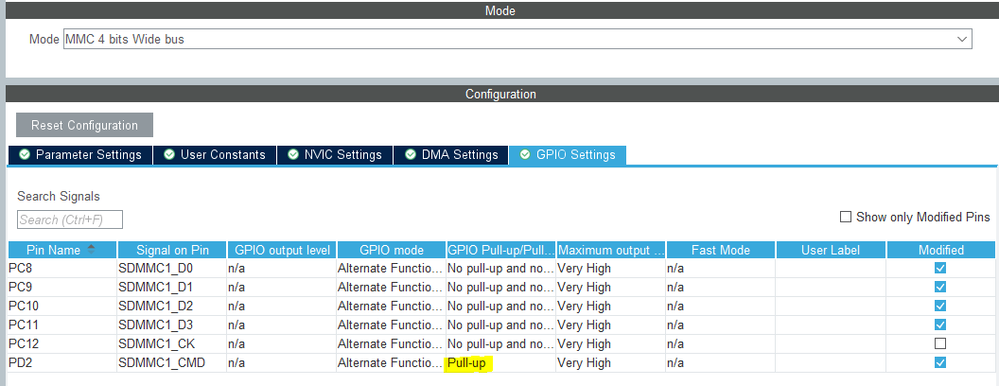

  • Use external crystal as clock source on the NUCLEO instead of HSI [will try out this]
  • SD breakout card setup [not sure what that would be?]

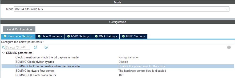

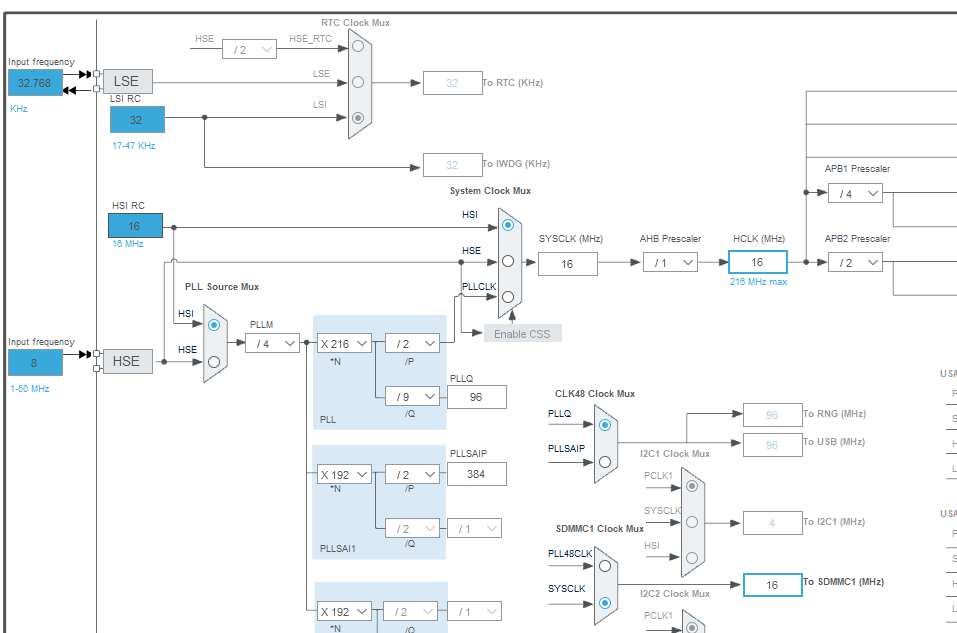

  • Wrong clock configuration, currently targeting between 100-400kHz with the MMC divider [?]
  • EMMC memory not supporting the CMD1 in the initialization [no idea if it could be like that?]

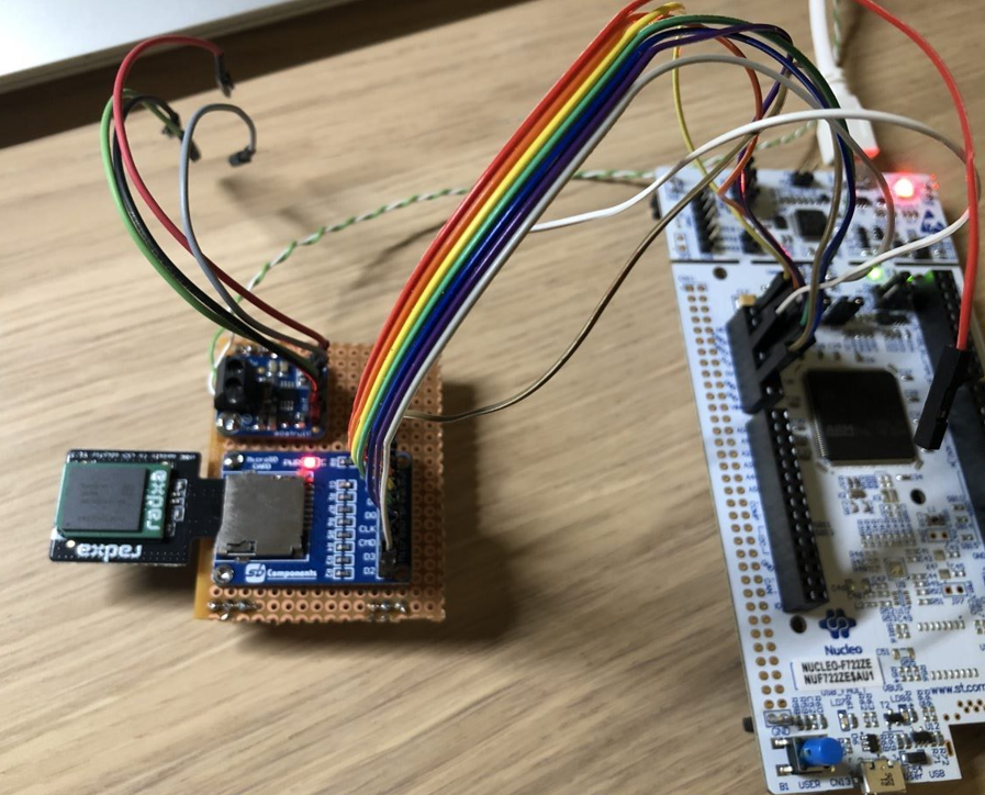

  • Bad cable connection on my test board [will make another inspection or perhaps make a solder]
  • More???
Code steps at failure

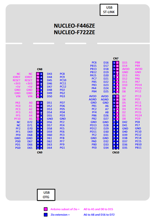

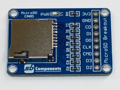

Hardware Setup
SD Breakout Connection

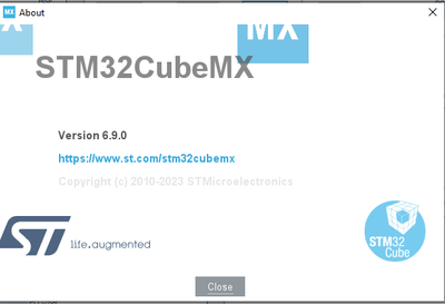

CubeMX Configuration
Software setup

I had similar problems with my STM32F407, the solution was to start with 1 bit and not 4 wide as my mmc did not support the 4 bits wide mode.
