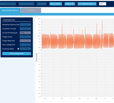

However, when I measure it with my STLINK Power Monitor, I get about ~10 µA with fast oscillations.

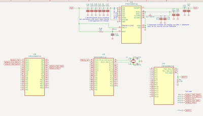

 on my custom board.
As it's a custom board, you need to show the schematics

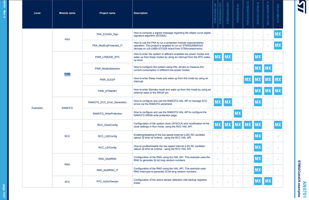

Have you tried the ST examples on an ST board for reference?
Have you tried the ST examples on your custom board ?
https://www.st.com/resource/en/application_note/an5701-stm32cube-mcu-package-examples-for-stm32u5-series-stmicroelectronics.pdf#page=11

This is my current hardware setup. The board is actually more complex, but at the moment the only components populated are the ones shown in the photo — all other pins are floating.
