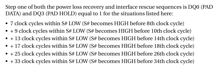

Use the power loss recovery sequence in the documentation of the flash memory and reset the nonvolatile configuration register. Big thanks to @Tesla DeLorean for pointing out the issue and providing a solution.
  1. Disable SPI.
  2. Set pin SPI_SCK, SPI_MOSI (DQ0), and HOLD (DQ3) as GPIO pins at very high max output speed.
  3. Insert the clock cycle function in your main.c. Run the GPIO sequence as shown in the code below.
  4. Power Loss Recovery Sequence is completed and extended SPI is now enabled.
  5. Verify working by reading the JEDEC ID of the flash memory.
  6. Reset the Nonvolatile Configuration Register by writing 0xFFFF to the nonvolatile configuration register. Ignore LSB requirement.
//Clock cycle function. void clock_cycle(uint8_t clocks){ HAL_GPIO_WritePin(GPIOA, GPIO_PIN_2, GPIO_PIN_RESET); for(uint8_t i = 0; i<clocks; i++){ HAL_GPIO_WritePin(GPIOA, GPIO_PIN_5, GPIO_PIN_SET); HAL_GPIO_WritePin(GPIOA, GPIO_PIN_5, GPIO_PIN_RESET); } HAL_GPIO_WritePin(GPIOA, GPIO_PIN_2, GPIO_PIN_SET); } //Insert this in main function // DO NOT USE BREAKPOINTS. SEQUENCE MUST BE COMPLETED WITHOUT INTERRUPTION //Step 1 printf("Starting step 1 power loss recovery sequence"); HAL_GPIO_WritePin(GPIOA, GPIO_PIN_0, GPIO_PIN_SET); //DQ3 HAL_GPIO_WritePin(GPIOA, GPIO_PIN_7, GPIO_PIN_SET); //DQ0 clock_cycle(7); clock_cycle(9); clock_cycle(13); clock_cycle(17); clock_cycle(25); clock_cycle(33); HAL_GPIO_WritePin(GPIOA, GPIO_PIN_0, GPIO_PIN_RESET); //DQ3 HAL_GPIO_WritePin(GPIOA, GPIO_PIN_7, GPIO_PIN_RESET); //DQ0 //Step 2 printf("Starting step 2 power loss recovery sequence"); HAL_GPIO_WritePin(GPIOA, GPIO_PIN_0, GPIO_PIN_SET); //DQ3 HAL_GPIO_WritePin(GPIOA, GPIO_PIN_7, GPIO_PIN_SET); //DQ0 clock_cycle(8); HAL_GPIO_WritePin(GPIOA, GPIO_PIN_0, GPIO_PIN_RESET); //DQ3 HAL_GPIO_WritePin(GPIOA, GPIO_PIN_7, GPIO_PIN_RESET); //DQ0 printf("Completed power loss recovery sequence");

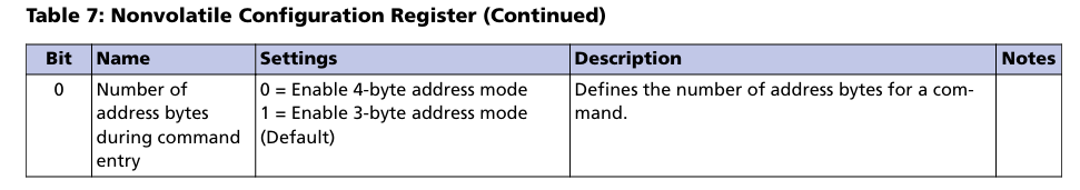

I am trying to reset bit 0 of the nonvolatile cfg to allow 4-byte addressing in commands by default after next reset.

Ok, but what pattern did you write to the device?
Not sure that writing random values is advisable or recoverable, especially if you've now put the device in DTR, DUAL or QUAD modes, via a 1-bit SPI interface.
Also you shouldn't need to BIT reverse the vector. It should read/write Little Endian
You can check the 3/4-byte mode via the FLAG STATUS REGISTER
There's a simple command to get it in the right mode ENTER 4-BYTE ADDRESS MODE B7h
Don't use NON-VOLATILE settings until you've got more experience, and have validated all the read methods.
I don't know what pattern was written. I coded an initialization function (without testing which was a mistake) that would copy the current nonvolatile cfg, reset bit 0, then write to nonvolatile cfg using the initial code provided which is now the current issue.
There is a section in the documentation called the Power Loss and Interface Rescue functions to reset the device to a fixed state (extended SPI) which is what I'm currently trying to do. However, I am having trouble understanding the documentation and have implemented it as shown below.
However, when testing this code, the device is still inaccessible only returning 0xFF consistently in read ID and other read functions.

HAL_StatusTypeDef MT25QL_InterfaceRescue(SPI_HandleTypeDef *hspi, MT25QL_FM_NO_t FM) { // Step 1: Recovery sequence recovery_sequence(hspi, FM, 7); // Example for 7 clock cycles recovery_sequence(hspi, FM, 9); recovery_sequence(hspi, FM, 13); recovery_sequence(hspi, FM, 17); recovery_sequence(hspi, FM, 25); recovery_sequence(hspi, FM, 33); // Step 2: Interface rescue interface_rescue(hspi, FM); return HAL_OK; } HAL_StatusTypeDef MT25QL_PowerLossRecovery(SPI_HandleTypeDef *hspi, MT25QL_FM_NO_t FM) { // Step 1: Recovery sequence recovery_sequence(hspi, FM, 7); // Example for 7 clock cycles recovery_sequence(hspi, FM, 9); recovery_sequence(hspi, FM, 13); recovery_sequence(hspi, FM, 17); recovery_sequence(hspi, FM, 25); recovery_sequence(hspi, FM, 33); // Step 2: Power Loss Recovery power_loss_recovery(hspi, FM); return HAL_OK; }
View more
Helper functions
static void recovery_sequence(SPI_HandleTypeDef *hspi, MT25QL_FM_NO_t FM, uint8_t clock_cycles) { uint8_t dummy_data[34] = {DUMMY_CLOCKS}; // Max needed cycles is 34 csLOW(FM); SPI_Write(hspi, dummy_data, clock_cycles); csHIGH(FM); } static void power_loss_recovery(SPI_HandleTypeDef *hspi, MT25QL_FM_NO_t FM) { uint8_t dummy_data[8] = {DUMMY_CLOCKS}; csLOW(FM); SPI_Write(hspi, dummy_data, 8); csHIGH(FM); //HAL_Delay(1); // Ensure tSHSL2 >= 50ns } static void interface_rescue(SPI_HandleTypeDef *hspi, MT25QL_FM_NO_t FM) { uint8_t dummy_data[16] = {DUMMY_CLOCKS}; csLOW(FM); SPI_Write(hspi, dummy_data, 16); csHIGH(FM); //HAL_Delay(1); // Ensure tSHSL2 >= 50ns }

Says to set DQ0 Bit HIGH on the pin interface, and DQ3/HOLD pin HIGH, and then clocking
Do you even connect the DQ3/HOLD pin in your design? Use a pull-up?
DUMMY_CLOCK is 0xFF in my code. Yes, DQ0 is connected to my MOSI line and DQ3 is held high by default using a GPIO pin.
Question, if I'm understanding this correctly, I should be sending 7 bits, cs HIGH, csLOW, 9 bits, cs HIGH, csLOW, then 13 bits, and so on?
My current implementation sends bytes currently so 7 bytes * 8 clocks / byte = 56 clock cycles.

You're sending a magic sequence of all ONEs to MOSI
You might have to do this sequencing void direct GPIO interaction, not using the SPI peripheral.
And you need a brief break time between sequences with the chip select.
Perhaps use a scope or logic analyzer to confirm the correct pattern if having trouble.
