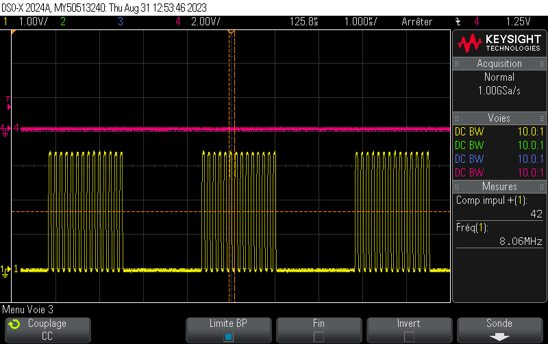

I'm implementing QSPI on STM32L451 with a NOR FLASH memory (Micron MT25QL512ABB, 64Mbytes) for the first time, using DMA, for the moment it seems to work, but I'm surprised by the timings.
CPU runs at 16MHz, QSPI clock speed is 8MHz. For this example I'm reading 256 bytes.
Full transaction :

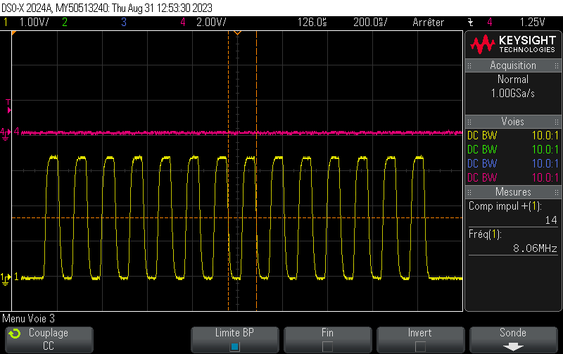

I'm surprised to see that the full read sequence is performed in burst of 7 bytes (14 clock cycles), spaced by approx 2µs delay between each burst. Since there is a FIFO on QSPI, there should no delay ? And why always 7 bytes bursts ?

Yes, this is the command I used. Where do you see 2 bytes for the data ? I'm reading 256 bytes... My first screenshot show a total of 538 clock cycles : 8 (instruction) + 4*2 (address) + 10 (dummy) + 256*2 (data) = 538. The data transaction part of the screenshots is split into bursts of 7 bytes, and I still do not understand why, I don't see your point when you counting the instruction and the address here...

I made new tests. If the QSPI clock (after prescaler) is equal or 2x lower than the AHB (CPU/DMA) clock, there are wait cycles between bursts, but if the QSPI clock is 4x lower (QSPI 16MHz and AHB 64MHz) there is no delay, all the data is read in single big burst.
It is possible that the kernel clock being used is bigger the bus clock. So, it reads faster than refreshing the registers!

Or maybe, if the AHB clock that runs the CPU and DMA is the same that the QSPI module (no prescaler), there are arbitrations that leads to "dead times" to let CPU doing its job (if he needs to access to  the same SRAM bank, an arbitration will be performed to avoid CPU stall (in my config the DMA priority is low). But when the AHB clock (CPU, DMA) is at least 4x higher than the final QSPI clock (prescaler = 1:4 minimum), there is enough time to let the CPU works while the DMA transfers the data from QSPI to SRAM as soon as available ?
