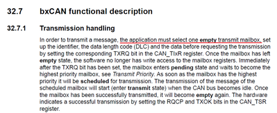

I want to understand behavior of TX mailbox here I am trying to send three ID but only i able to see two ID at a time in TI0R. I have fewer doubts which I hope you can clear.
Doubt 1:  Do I have to use three different mail box for three ID or One is enough .
Doubt 2. Like in RX mailbox I have locking mechanism in which I can see different RX frame in RXFIFO0 so I mean to say It can hold upto three different messages. So is there any logic in TX mailbox also to locked or to see all ID because I think it is overwriting the buffer.

First, please see How to insert source code , I've edited your post.
Second, not sure what the problem is, but when sending a CAN frame you need to select an empty mailbox (it's already managed in the HAL).
Please review the reference manual:
See also the HAL implementation of HAL_CAN_AddTxMessage():

mƎALLEm

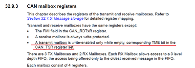

HI
So when to set this TME0 in TSR during intialization time .
can you tell me when to set and when I can Clear this bit or only one time during initialization I have to  set.
Explain me in theory .
B.R
Ashish
Did you read the reference manual?
And you don't have to care of that when you are using HAL.
