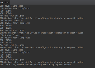

you can get more than printf :  statistics...
or just - for usb testing- the messages :
It CAN work - just no simple and clear rules.

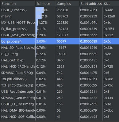

How would I go about viewing the information in the first screenshot?

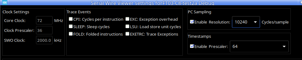

in debug , (paused) or waiting at breakpoint :
1. open : menu: window -> Show View -> SWV -> SWV statistical profiling
2. open the "toolbox" (configure) :
+ here set PC sampling : ena.resolution -> not too fast (try: 10240 , as i choose here)
(+ enable prescaler /64 ; )
(+ check: on left shows your real actual core clock speed ? If wrong, nothing will work on SWV !!! )
-> ok.

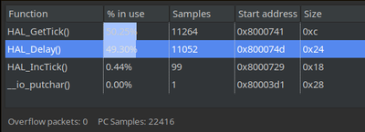

Then "play" , resume debug, let program run some seconds, then "pause" debug again --- and you get statistics for this some seconds of program runnning :
<- this is just the main i showed (only printf() + hal_delay in while loop)
 + afaik this will fill up the sample buffer in the IDE (the faster/more you sample, the shorter time until overflow! );
so for longer debug session (= normal use) you have to un-check the PC_sampling , to avoid overflow .
