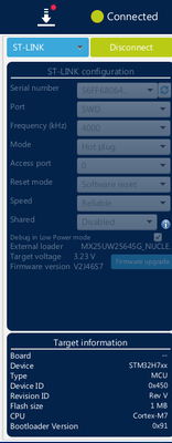

Connect st-link to board and try connect in CubeProgrammer, show what its telling.
set software reset;
ex. with st-link V2 "stick" :

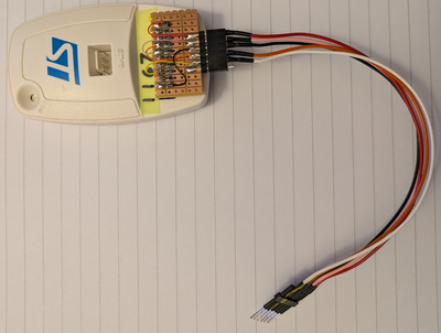

I guess you now have a genuine ST-Link?

-I manage to use shorter dupont as possible to link breakout board to my board.
Although short is good, so-called "dupont" leads are prone to be unreliable - a proper debug cable & connectors would definitely be preferable.
What do you mean by "breakout board" here?
Again, photos would help.

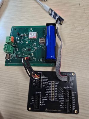

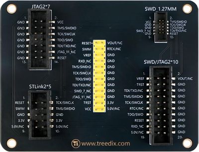

I understand tha a proper  debug cable is preferable but I designed my board with a 6 pins header for debug and programming :  Here is the breakout board

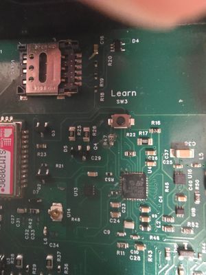

@Fabrice44 wrote:
 Footprint is identical to STM datasheet.
So I'm confident that MCU is correctly oriented
That doesn't follow: the package is square, so it will "fit" in 4 different orientations on the footprint - only one of those will work!

I understand that a proper  debug cable is preferable but I designed my board with a 6 pins header for debug and programming
So you're connecting from the STLink to this breakout, and then from the breakout to your PCB?
Plenty of scope for errors & poor connections there!
Why not just go straight from the STLink to your board?
How do you connect the STLink to breakout?
Why not just make a cable to connect direct from the STLink to your board; eg,
Here is some photos
Thanks.
Can you get a better closeup of the STM32?
