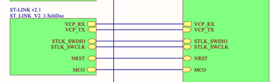

Connection
So the STMG0 doesn't actually connect to the USB device.  It has a uart connection that talks to the programing STM32F0 chip.

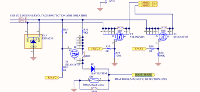

Read switch
Here's the read switch.  It does some kind of protection.  Just not sure what it does.
Code
You do a HAL_NVIC_SystemReset. Every time there a change in DOOR_SENSE_PIN.
But i don't really see where the uart comm's happen.

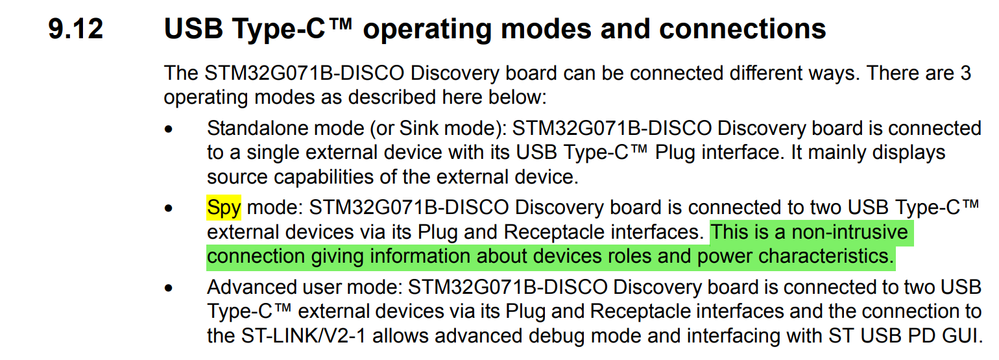

Indeed this workflow is required because SPY mode is a passive sniffer role and doesn’t present itself as a USB device to the host PC. It is designed to provide trace data for debugging purposes. It's mentioned in User manualonly the trace is available.
Also in wiki, if the GUI responder is not activated (_GUI_INTERFACE compilation switch) in the embedded firmware (It is the case for the STM32G071B-DISCO, when the blue door is open = spy mode), the debug information are available (UART through VCP of the STLink, and the compilation switch _TRACE activated) you may still see the trace in UCPD monitor by clicking on the Trace button in the bottom right corner.

The firmware simply never brings up the USB device stack neither in spy mode nor in sink mode. Windows never sees a USB device, and in spy mode there is nothing for the UCPD Monitor to connect to over USB.
What you are expecting is not feasible with this context.
