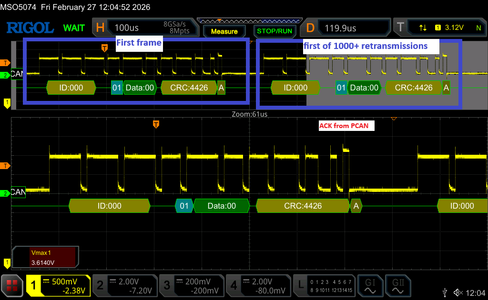

I set up a STM32U575I-EV board for communication with CAN. The STM Board, a PCAN-USB dongle and an Oszilloskope are connected to the bus. The Bus is terminated correctly with two 120 Ohm resistors. I use the HAL libraries to interface with the FDCAN peripherie. The jumpers from the eval board are set to connect PB9 and PB8 with the CAN transceiver and to disconnect PB8 from the USB-C PD-interface.
To test the setup I send dummy frames (ID: 0x000, DLC: 1, Data: 0x00). The frame is visible on the Bus and also the ACK from PCAN is visibile. PCAN USB has a 200mV higher voltage on CAN High 0 level.
Here is the dummy frame on the Oszi:
As you see on the the screenshot, the ACK is there and even though I put only one message in the Tx-Buffer of the FDCAN, it retransmitted.

"status" from main() gives me a LastErrorCode of Stuff error, Form error and Acknowledge error (0b0..0111).
What I have tried:
- Run release build instead of Debug -> same result
- run FDCAN in external loopback mode -> same result (?!). So the CAN module does resend the frames even though it should ignore ACK errors ( reference manual page 3034)
- When I poll for Rx frames and send frames via PCAN I receive every ~10th frame
Anybody has an idea?

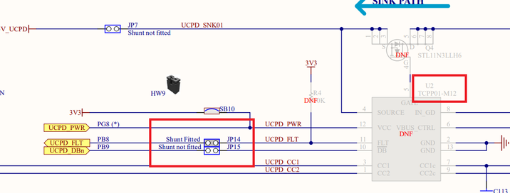

Hello @finally and welcome to the ST community,
I don't know if U2 is present in your board. In thar case you need to remove the jumpers JP14 and JP15.
Otherwise that's weird if the loopback mode has issues ..
Hi @mƎALLEm ,
these jumpers were removed.
