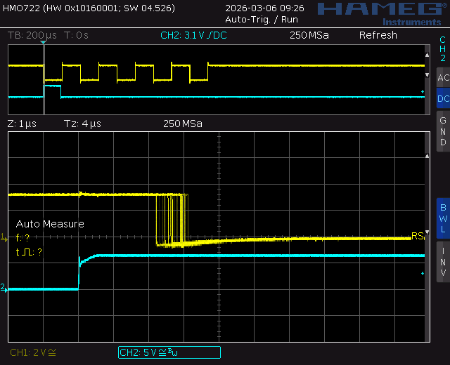

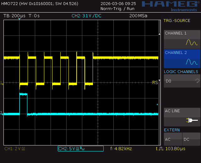

Find attached the clock setup and logic analyzer captures that show the inconsistency of the timing.

I understand. The time between when you send data to UARTx->DR and the time the TX line goes low (beginning of the START bit) has a jitter of 1 bit period. At 9600 baud, this is 105 us, which is what you see. There's no way around this.
One time the delay can be 5 us, the next it can be 105 us.

What he describes is not software jitter. It is a feature of the UART on the F4. I decided to test it myself, and it is true—there is a 1-bit jitter (so it depends on the baud rate). The datasheet does not discuss this in detail.
