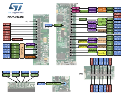

This is the pinout for the STM32F469I-DISCO and OV2640, I have been able to find pins for most of them but am having trouble:
  • DCMI Pinout: (Pin function : Actual pin name)
    • DCMI_D0 : PC6
    • DCMI_D1: PC7
    • DCMI_D2: PG10
    • DCMI_D3: PG11
    • DCMI_D4: Missing
    • DCMI_D5: PD3
    • DCMI_D6: Conflict with PB8
    • DCMI_D7: Conflict with PB9
    • DCMI_VSYNC: PG9
    • DCMI_HSYNC: PA4
    • DCMI_PIXCLK: PA6
    • RCC_MCO_1: PA8 (Note: we can use this pin to generate the XCLK signal needed by the OV2640
    • SIOC: PB8
    • SIOD: PB9
I would appreciate it if anyone has a solution for this, thanks

The datasheet of the chip lists all pins available for DCMI functions.
> DCMI_D4: Missing
PE4 or PH14
Those pins are already in use on the board and aren't exposed on any headers, so you'll need to do that manually.
https://www.st.com/resource/en/schematic_pack/mb1189-c01_schematic.pdf
Generally Nucleo board are better for connecting dense external peripherals. On discovery boards most pins are already in use.
So if there are no exposed pins then am I better off buying another board or is there another way to still use it?
It can be done if you have the experience and equipment to solder wires to a trace or to pads. But a different board is going to be much easier.
