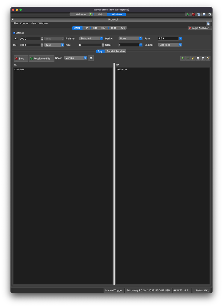

I have to connect an STM34 Nucleo board to a TMC2209. I have to setup a single wire UART. Only TX is connected with the TMC board.
I transmitted a datagram and when I try to receive the response I get back the initial data I have e sent.
Does anybody know what could be happening?

Now I am sure I am calculating the right the CRC is the one from the TMC2209 datasheet, Something that is not explained correctly in the data sheet is that when sending a read of the register one has to send 4 bytes (the data part which must be included in the writing datagram must be omitted 32 bits). I am now sending a basic read with 4 bytes only as it should. And get no reply from the TMC. I think datagram {0x05, 0x00, 0x00, 0x48} is a valid one. But in my protocol analyser tool I can only see the command I sent but no reply.
I will continue trying other links you sent me.
2022-10-17 1:39 AM
I have also tried with your TMC2209_SendReceive function. No error showing up.
It sounds like the TMC2209-eval board is not receiving the TX datagram. Because at this point there might be a response showing up at least on the protocol analyser for UART that I have attached to the TX and RX pins. Am I right?

2022-10-31 9:20 PM
Sorry, it took me a while to reply but I have been very busy implementing this. One day before you wrote me I received a TMC2209-BOB and it worked perfectly as intended.
You are right. The TMC2209-eval board is not working even well with the whole evaluation kit… it is incredible that one gets charged for such expensive board when the documentation is not aligned and the hardware is not working at all as intended… I ordered also a TMC5160 evaluation kit which uses SPI and that was working fine from scratch. But the TMC2209-eval kit is totally messed up.
