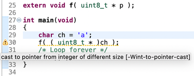

Unfortunately, the mistake was masked by the (uint8_t*) cast - without that, you'd have got a compiler warning...
GCC does generate a warning for it:
