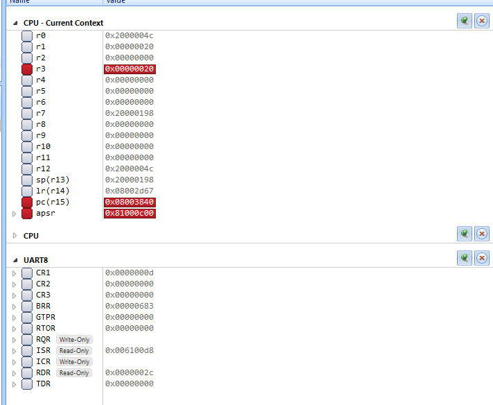

‎2020-06-18 1:42 AM
Here is the Registers while running, the only thing change is the ISR Busy bit. the rest stays the same
‎2020-06-18 2:07 AM
In UART_SR, ORE is set, whih means the UART already received some bytes which it did not "pick" from the data register. At the same time, RDR is 0 - do you receive all zeros?
It might also be that your baudrate is not what you think. UART_BRR is suspiciously low, indicating APB frequency of 21.35MHz - is this the case? Try to transmit and observe Tx pin using LA or oscilloscope.
Does it receive if you *don't* observe the UART registers in the debugger?

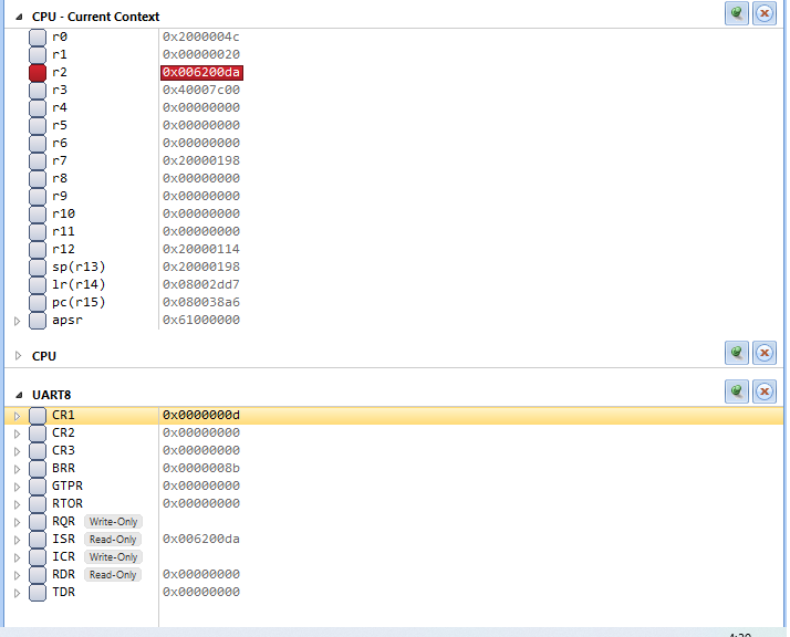

‎2020-06-18 2:18 AM
I notice that the init is not properly done, after I do a fix on the following code:
/* USER CODE END UART8_Init 0 */
/* USER CODE BEGIN UART8_Init 1 */
//static const UART_HandleTypeDef EmptyStruct;
huart8 = (const UART_HandleTypeDef){0}; <-- FIX to flush out all garbage before init
/* USER CODE END UART8_Init 1 */
huart8.Instance = UART8;
huart8.Init.BaudRate = 9600;
huart8.Init.WordLength = UART_WORDLENGTH_8B;
huart8.Init.StopBits = UART_STOPBITS_1;
huart8.Init.Parity = UART_PARITY_NONE;
huart8.Init.Mode = UART_MODE_TX_RX;
huart8.Init.HwFlowCtl = UART_HWCONTROL_NONE;
huart8.Init.OverSampling = UART_OVERSAMPLING_16;
huart8.Init.OneBitSampling = UART_ONE_BIT_SAMPLE_DISABLE;
huart8.AdvancedInit.AdvFeatureInit = UART_ADVFEATURE_NO_INIT;
if (HAL_UART_Init(&huart8) != HAL_OK)
Error_Handler();
the register become:
but still stall at the same place ...
