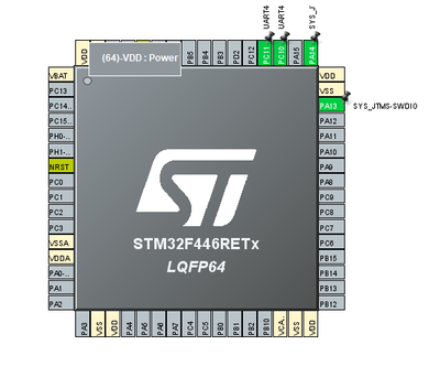

Actually, I just initialize the UART 4 and the SWD interface for programming the board. (As you can see in the image below). I have even delete the HSE initialization, for checking if it was and issue related with the clock, but this didn't make any difference.
