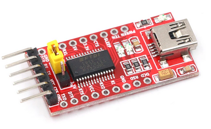

i find ftdi's usb-UART modules very usefull to debug this kind of scenarios.
**extra: i had some problems back in the day with the raspi's internal bluetooth trying to take over the uart i was using .....
