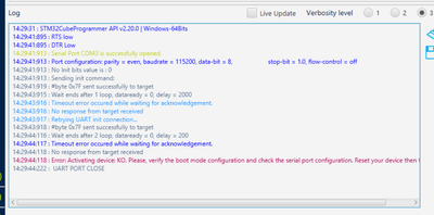

What do you mean by "cannot work with the MCU"?
Show screenshot(s) of the error you are facing with CubeProgrammer. You can also play with the verbosity level to show more messages:

I have captured the log as follows.
14:29:31 : STM32CubeProgrammer API v2.20.0 | Windows-64Bits
14:29:41:895 : RTS low
14:29:41:895 : DTR Low
14:29:41:913 : Serial Port COM3 is successfully opened.
14:29:41:913 : Port configuration: parity = even, baudrate = 115200, data-bit = 8, stop-bit = 1.0, flow-control = off
14:29:41:913 : No Init bits value is : 0
14:29:41:913 : Sending init command:
14:29:41:919 : #byte 0x7F sent successfully to target
14:29:43:915 : Wait ends after 1 loop, dataready = 0, delay = 2000
14:29:43:916 : Timeout error occured while waiting for acknowledgement.
14:29:43:916 : No response from target received
14:29:43:917 : Retrying UART init connection...
14:29:43:918 : #byte 0x7F sent successfully to target
14:29:44:116 : Wait ends after 2 loop, dataready = 0, delay = 200
14:29:44:117 : Timeout error occured while waiting for acknowledgement.
14:29:44:118 : No response from target received
14:29:44:118 : Error: Activating device: KO. Please, verify the boot mode configuration and check the serial port configuration. Reset your device then try again...
14:29:44:222 : UART PORT CLOSE
