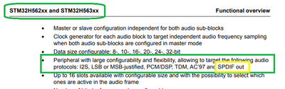

asking AI about this:  is SAI spdif output avail in H563 serie ?
SAI SPDIF Output Availability in STM32H563 Series
The STM32H563 series supports SPDIF output via its Serial Audio Interface (SAI) peripheral. Both SAI1 and SAI2 blocks on STM32H563xx devices are capable of SPDIF output when configured as transmitters.
Supported SAI Blocks and Configuration Requirements
  • SAI Blocks: Both SAI1 and SAI2 can be used for SPDIF output.
  • Configuration: To enable SPDIF output, configure the SAI audio block as a transmitter. The SAI peripheral supports a wide range of audio protocols, including SPDIF, and offers flexible options such as master/slave mode, configurable data size (8- to 32-bit), and various frame/slot settings. For SPDIF, the block must be set as a transmitter, and the protocol/frame configuration must match SPDIF requirements.
How to Configure SAI for SPDIF Output & Special Considerations
  • Register Settings:
    • Set PRTCFG[1:0] bits to 01 in the SAI_xCR1 register to select SPDIF mode.
    • Only the SD data line is enabled; FS, SCK, and MCLK I/Os are unused.
    • MODE[1] is forced to 0 (master mode), enabling the SAI's clock generator.
    • Data size is fixed at 24 bits; DS[2:0] bits are ignored.
    • The SAI's clock generator must be set so the bit clock is twice the symbol rate (Manchester coding).
    • SAI_xFRCR and SAI_xSLOTR registers are ignored in SPDIF mode.
  • SPDIF Frame Structure:
    • Each SPDIF block contains 192 frames, each with two 32-bit subframes (left/right channels), with 24 data bits and 4 status bits per subframe.
  • Limitations:
    • SPDIF is available only in transmitter mode.
    • Data size is fixed at 24 bits.
    • Only the SD line is used for data output.
    • The configuration is more restricted compared to other audio protocols to comply with SPDIF requirements.
Summary
Yes, the STM32H563 series supports SAI SPDIF output on both SAI1 and SAI2 blocks, but only in transmitter mode. Configuration requires setting the SAI to SPDIF mode with specific register settings, and there are some limitations such as fixed data size and use of only the SD line.

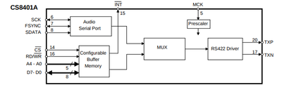

As spdif transmitter i already used CS8401 and expected similar function, as a real spdif transmitter:
So the spdif output on SAI is just a serial output using biphase mark code , the channel status etc you have to puzzle together ... 192 times, to get a valid frame block.
@waclawek.jan
Your right, i just was disappointed by the "low level" spdif transmitter.
