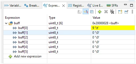

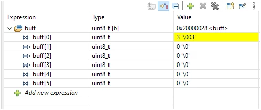

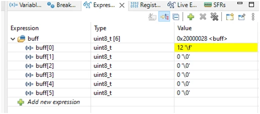

I've been doing a small project lately and ran into a problem in one part. I have two STM32 microcontrollers and I want to communicate both of them with eachother over UART. One of them is designed to send a fixed array of 6 characters
uint8_t k[6]={3,7,9,12,16,19};
The other microcontroller is simply to receive it. When I send a single byte over the UART it all works without a problem. When I want to send the whole array it only fills the first element.This first element is filled with random numbers from this sent array.
I know for sure there is no problem on the sending side. I checked it on an oscilloscope. The problem lies in the receiving side.
I suspect that the problem lies in the timing, but I don't know how to fix it
In both microcontrollers the baud rate is the same – 9600. The data frame is also the same 8N1.

‎2024-04-17 9:25 AM
Boards have crossed RX and TX. In both STM I used HSI and for both microcontrolers clock settings are the same.
I checked the timing for both microcontrolers (I send 0x55 to have this rectangular transmision shape) and bit duration is 104us so it seems like it is ok.
Also I checked what this HAL_UART_Transmit function returns and sometimes it returns HAL_TIMEOUT and sometimes HAL_OK
Grounds are OK. I power supply both microcontrollers from the same source.
‎2024-04-17 9:29 AM
That's my mistake. I mean integers not characters. Even when I start transmission after 10 minutes after power up it fills only first element of the array.
