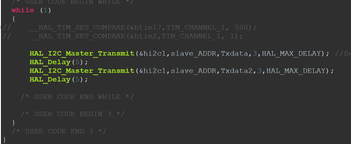

Master code:
I checked the SDA and SCL with different transferred data Txdata and Txdata2.
But two consecutive pulses series are totally same.
There is any idea about this problem.

[1] The master MCU could transmit the data because I could get the waveform, and each series of pulses is generated at each 5ms (see code).
[2] In code, I try to transmit two different data (Txdata = "A" and Txdata1 = {0x04, 0x05, 0x06}) each 5ms however the two consecutive series of pulse are 100% same. Why? any idea? So, it looks like the root cause does not only come from pull-up technique but also may from some others.

The first byte of data will contain the slave address. That byte will be the same regardless of the data bytes being sent. It looks like the peripheral only gets a few bits into the transaction before giving up. Looks like it's waiting for SDA to rise or something.
You need to solve the external pullup issue before going further. You could also slow down the clock speed by a factor of 100x or so to get it to work with the internal pullups.

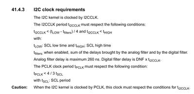

Only case [3] can work. What could be the rules of frequency and speed setting?
I could find a I2C CLK requirement in reference manual but not so sure any things related?
Thanks again for very useful suggestions until now.
