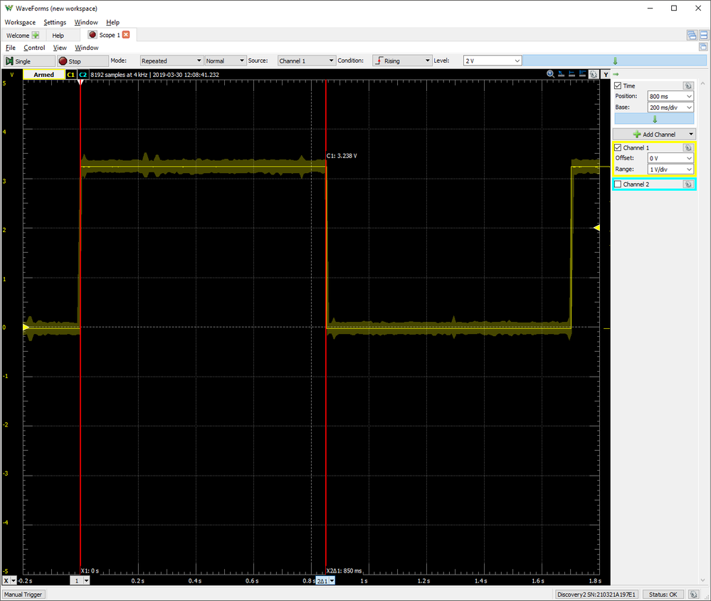

Its seems like LPTIM1/2 One-pulse mode is exactly what I need (If I understood the functionality correctly). If I set LSI as clock source (32k) and set the prescaler to 32, it would give me 1 ms time base. So in order to make a 1500 ms pulse I would do:
HAL_LPTIM_OnePulse_Start(lptim_handle, 1500, 0);
I dont have the scope with me, so will be able to test it later only. Thanks for the hint.
‎2019-03-30 4:12 AM
I have checked the LPTIM functionality with scope. It works as its supposed to. Bellow an 850 ms pulse is being generated with:
HAL_LPTIM_OnePulse_Start(lptim_handle, 850, 0);
32k LSI as LPTIM1 source with /32 divider.
