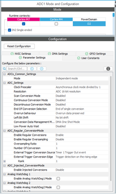

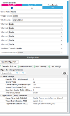

i am trying to use the Timer 1 to capture on the rising edge using the analog to digital converter
those are my signals the lase one (pink is my signal that i want to capture at this frequency)
those are my IOC settings
on the input of the ADC I have an analog signal Syncronised on timer one for capture
i try using this Tutorial and only obtain those results:

my code for this is
#define CCDBuffer 6000
volatile uint16_t CCDPixelBuffer[CCDBuffer];
uint16_t ProcessingBuffer[CCDBuffer];
HAL_TIM_PWM_Start(&htim4, TIM_CHANNEL_1); //sh
HAL_ADC_Start_DMA(&hadc1, (uint32_t*)CCDPixelBuffer, CCDBuffer);

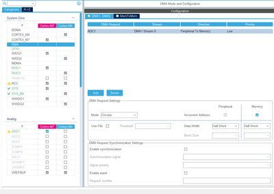

Your DMA is in normal mode. The tutorial has it in circular mode.
Thank you so mutch for you repply it is really appreciated
i  have change the mode to circular mode but now i have no data output sample its not running enven once before stopping did i miss something else thak you for any help i relly appreciate it
EDIT i change the priority to HIGH and the setting for my code is:

in big you need to remap to ramd2
main code:
void StartAcquisition(void);
void StopAcquisition(void);
__attribute ((section(".adcarray"))) uint16_t ADC_VAL[3694];
void StartAcquisition(void) {
	BSP_LED_On(LED_YELLOW);
    __HAL_TIM_SET_COUNTER(&htim2, 95);
    __HAL_TIM_SET_COUNTER(&htim4, 75);
    HAL_TIM_PWM_Start(&htim3, TIM_CHANNEL_1); // fm
    HAL_TIM_Base_Start(&htim1);               // adc trigger
    HAL_TIM_PWM_Start(&htim2, TIM_CHANNEL_1); // icg
    HAL_TIM_PWM_Start(&htim4, TIM_CHANNEL_1); // sh
    HAL_ADC_Start_DMA(&hadc1, (uint32_t *)ADC_VAL, 3694);
