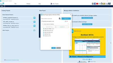

Step 1: Navigate to the [Board Selector] (optionally use the BSP to configure LEDs, user button and virtual com port "VCP")

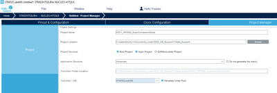

Step 2: Choose [Appli] and [Boot] projects generation, as we’ll put the application code into an external memory, refer to this KB article for complete project configuration.

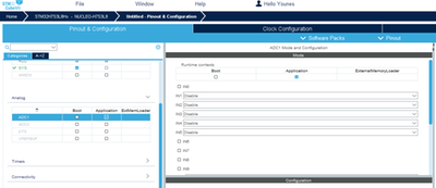

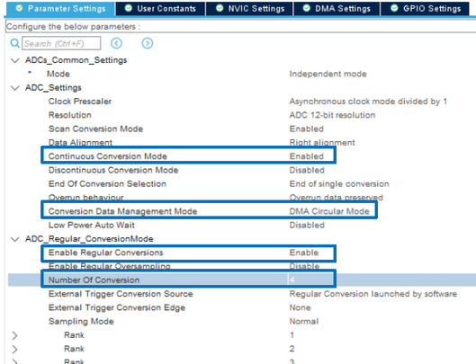

Step 3: Select [ADC1] and assign it to [Appli] project.

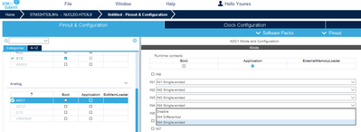

Step 4: Enable the ADC channels that you need (4 channels are enabled here).
Step 5: Configuration
  • Set [Continuous conversion mode] to [Enable]. This option loops the ADC. When the ADC finishes converting all its channels, it will start again from the beginning.
  • Set [Enable Regular Conversions] to [Enable].
  • Configure ADC 1: Set [Conversion Data Management Mode] to [DMA Circular Mode].
    After the ADC converts value, it will create a request for the DMA. Circular mode here means that after the ADC finishes all the regular channels, it continues to generate DMA requests in the next run.

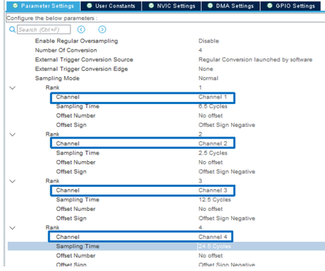

  • Set the [Number of conversion] to [4] (or your preferred value). This will set ADC to do 4 ADC
    conversion which we can set.
Step 6: Choose the sequence. You can set the ADC channel for each rank. Each rank is assigned one ADC channel to convert. It's possible to select the same channel each time.

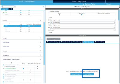

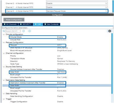

Step 7: Go to the HPDMA settings.
  • Select [CH0]
  • Set [Circular Mode] to [Enable]
  • Set [Request] to [ADC1]
  • Set [Source Data Settings] data width to [Half Word]
  • Set [Destination Data Settings] data width to [Half Word]
  • Set [Destination Address Increment After Transfer] to [Enable]
Step 8: Generate the code.

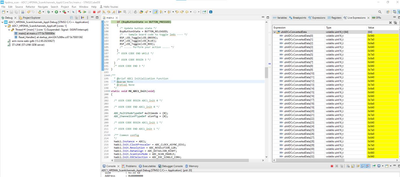

2. Test results
Results in the debug windows are continuously updated as the ADC DMA transfer is in a circular mode. To check the converted values from the table, suspend the debug and analyze the result from the debug watch window.
