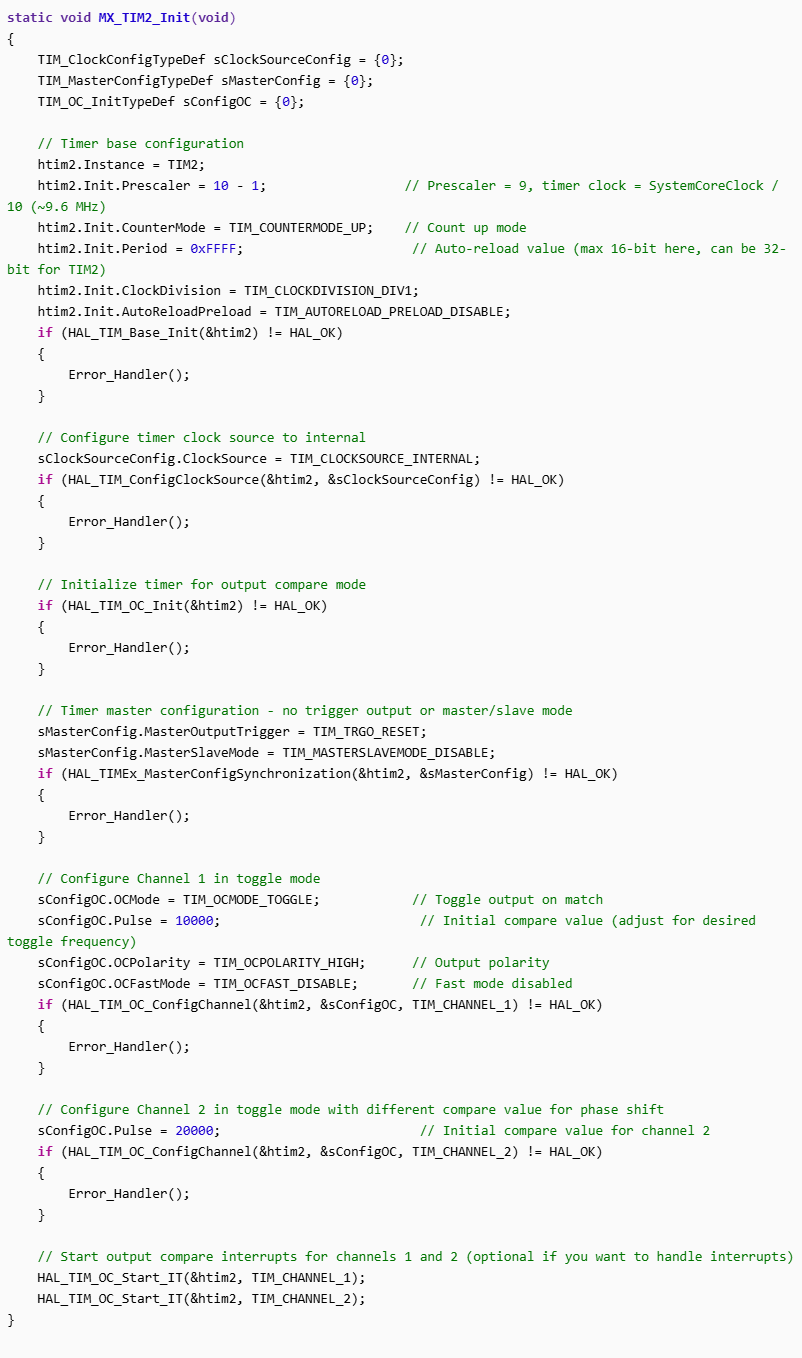

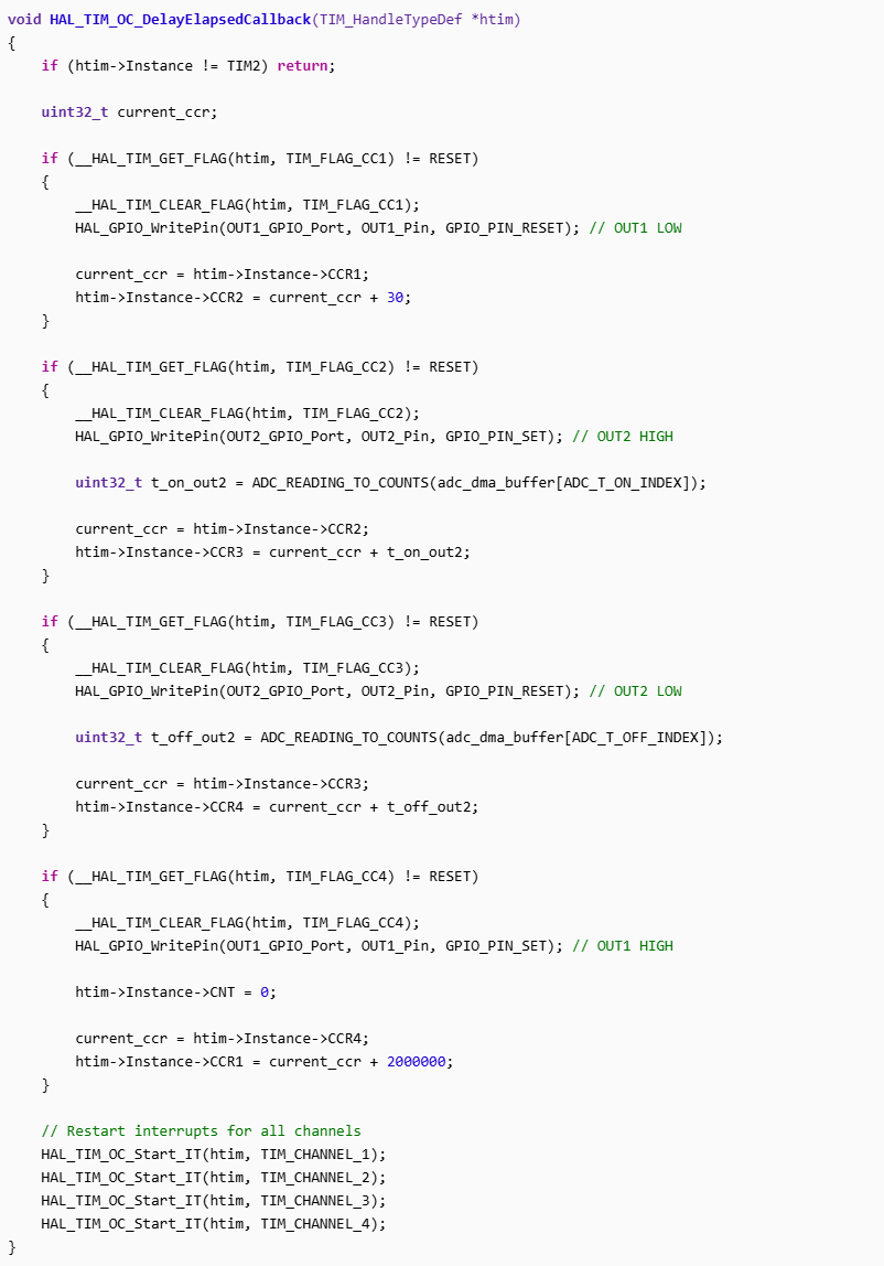

Trying to make a single pulse test.
MagnusNTNU
Hi, I am currently trying to make a single pulse test jig I can use to test MOSFETs in an series resonant converter. I am using the STM32F411CEU6.
I am trying to make a state machine that can make these signals at two different pins. The two variable periods I would like to control with a potentiometer connected to ADC1_IN1 and ADC1_IN2.
However, I only see a high pulse on one of the output and only low on the other. I am trying to use TIM2 as an output compare timing mode where I am using the four different channels and their respective CCRx to toggle the output how I want them. I have tried debugging my code. And it seems like the interrupt fires from the CC1IF but when I am checking in the flag is set it has already been reset and my if sentence won't run. I have attached the code under you would be so kind to take a look.
Thanks

void HAL_TIM_OC_DelayElapsedCallback(TIM_HandleTypeDef *htim)
    if (htim->Instance != TIM2) return;
    uint32_t current_ccr;
    // --- CCR1: OUT1 LOW (Trinn 1) ---
    if (__HAL_TIM_GET_FLAG(htim, TIM_FLAG_CC1) != RESET)
        __HAL_TIM_CLEAR_FLAG(htim, TIM_FLAG_CC1);
        HAL_GPIO_WritePin(OUT1_GPIO_Port, OUT1_Pin, GPIO_PIN_RESET); // OUT1 LAV
        // Planlegg CCR2 (OUT2 HIGH) 3us (30 tellinger) senere
        current_ccr = htim->Instance->CCR1;
        htim->Instance->CCR2 = current_ccr + 30;
    // --- CCR2: OUT2 HIGH (Trinn 2) ---
    else if (__HAL_TIM_GET_FLAG(htim, TIM_FLAG_CC2) != RESET)
        __HAL_TIM_CLEAR_FLAG(htim, TIM_FLAG_CC2);
        HAL_GPIO_WritePin(OUT2_GPIO_Port, OUT2_Pin, GPIO_PIN_SET); // OUT2 HØY
        // Les ADC1 for T_ON
        uint32_t t_on_out2 = ADC_READING_TO_COUNTS(adc_dma_buffer[ADC_T_ON_INDEX]);
        // Planlegg CCR3 (OUT2 LOW)
        current_ccr = htim->Instance->CCR2;
        htim->Instance->CCR3 = current_ccr + t_on_out2;
    // --- CCR3: OUT2 LOW (Trinn 3) ---
    else if (__HAL_TIM_GET_FLAG(htim, TIM_FLAG_CC3) != RESET)
        __HAL_TIM_CLEAR_FLAG(htim, TIM_FLAG_CC3);
        HAL_GPIO_WritePin(OUT2_GPIO_Port, OUT2_Pin, GPIO_PIN_RESET); // OUT2 LAV
        // Les ADC2 for T_OFF
        uint32_t t_off_out2 = ADC_READING_TO_COUNTS(adc_dma_buffer[ADC_T_OFF_INDEX]);
        // Planlegg CCR4 (OUT1 HIGH)
        current_ccr = htim->Instance->CCR3;
        htim->Instance->CCR4 = current_ccr + t_off_out2;
    // --- CCR4: OUT1 HIGH / Syklusstart (Trinn 4) ---
    else if (__HAL_TIM_GET_FLAG(htim, TIM_FLAG_CC4) != RESET)
        __HAL_TIM_CLEAR_FLAG(htim, TIM_FLAG_CC4);
        HAL_GPIO_WritePin(OUT1_GPIO_Port, OUT1_Pin, GPIO_PIN_SET); // OUT1 HØY
        // *** TILBAKESTILLER CNT ***
        htim->Instance->CNT = 0; // Sett telleren til 0 for å starte en ny, frisk syklus.
        // Planlegg CCR1 (OUT1 LOW) 200ms (2,000,000 tellinger) senere
        current_ccr = htim->Instance->CCR4;
        htim->Instance->CCR1 = current_ccr + 2000000;
    // For å sikre at interruptene fortsetter å trigge, må vi alltid aktivere de på nytt
        HAL_TIM_OC_Start_IT(htim, TIM_CHANNEL_1);
        HAL_TIM_OC_Start_IT(htim, TIM_CHANNEL_2);
        HAL_TIM_OC_Start_IT(htim, TIM_CHANNEL_3);
        HAL_TIM_OC_Start_IT(htim, TIM_CHANNEL_4);

  htim2.Instance = TIM2;
  htim2.Init.Prescaler = 10-1;
  htim2.Init.CounterMode = TIM_COUNTERMODE_UP;
  htim2.Init.Period = 4294967295;
  htim2.Init.ClockDivision = TIM_CLOCKDIVISION_DIV1;
  htim2.Init.AutoReloadPreload = TIM_AUTORELOAD_PRELOAD_DISABLE;
  if (HAL_TIM_Base_Init(&htim2) != HAL_OK)
    Error_Handler();
  sClockSourceConfig.ClockSource = TIM_CLOCKSOURCE_INTERNAL;
  if (HAL_TIM_ConfigClockSource(&htim2, &sClockSourceConfig) != HAL_OK)
    Error_Handler();
  if (HAL_TIM_OC_Init(&htim2) != HAL_OK)
    Error_Handler();
  sMasterConfig.MasterOutputTrigger = TIM_TRGO_RESET;
  sMasterConfig.MasterSlaveMode = TIM_MASTERSLAVEMODE_DISABLE;
  if (HAL_TIMEx_MasterConfigSynchronization(&htim2, &sMasterConfig) != HAL_OK)
    Error_Handler();
  sConfigOC.OCMode = TIM_OCMODE_TIMING;
  sConfigOC.Pulse = 0;
  sConfigOC.OCPolarity = TIM_OCPOLARITY_HIGH;
  sConfigOC.OCFastMode = TIM_OCFAST_DISABLE;
  if (HAL_TIM_OC_ConfigChannel(&htim2, &sConfigOC, TIM_CHANNEL_1) != HAL_OK)
    Error_Handler();
  if (HAL_TIM_OC_ConfigChannel(&htim2, &sConfigOC, TIM_CHANNEL_2) != HAL_OK)
    Error_Handler();
  if (HAL_TIM_OC_ConfigChannel(&htim2, &sConfigOC, TIM_CHANNEL_3) != HAL_OK)
    Error_Handler();
  if (HAL_TIM_OC_ConfigChannel(&htim2, &sConfigOC, TIM_CHANNEL_4) != HAL_OK)
    Error_Handler();

Thank you for the detailed description and the code. Your approach using TIM2 output compare channels and ADC inputs for variable timing is good, but the issue with only one output toggling and the interrupt flags being cleared before your if checks likely comes from the way the interrupt flags are handled and the logic in your callback.
In your HAL_TIM_OC_DelayElapsedCallback you check the flags sequentially with if ... else if ... else if. However, the interrupt flags for multiple channels can be set simultaneously or very close in time, and the first if that matches clears the flag, so the subsequent checks never see their flags set.
Recommended fix:
  • Check and clear the flags for all channels independently, not using else if.
  • This ensures that if multiple channels triggered, you handle all their events.
Additional Debugging Tips
  • Add debug output (e.g., toggle another GPIO or send UART message) inside each CCR flag handler to confirm all stages are reached.
  • Check the timer interrupt priority and ensure no other interrupts block it.
  • Verify your GPIO pins are connected correctly and no hardware issues.
Isn't that consistent with the timing diagram in your post?
Without looking into all details of your code, I would suspect that HAL is probably too slow to cope with µs timings for interrupts. It may be better driving two pins directly by timer channels, say Tim2_Ch1 on PA0 and Tim2_Ch2 on PA1.
You can use output compare in toggle on match mode. The CCR1 and 2 register values detemine the next edge. They can be "auto" updated from an array of values by a circular DMA.

@Aime Thanks for the reply, I tried with only IF sentences but still got the same result. I suspect that KnarfB might be right in the fact that HAL is to slow at handling the us interrupts

If that is the case you should try to change the Timer Output Compare Mode as suggested by @KnarfB.
You are using TIM_OCMODE_TIMING which does not toggle pins automatically.
  • You manually toggle GPIO pins in the callback, which is fine, but make sure the pins are configured as GPIO outputs (which you do).
  • If you want the timer to toggle pins automatically, you could use TIM_OCMODE_TOGGLE and let hardware do the toggling.
Here is a exemple:
TIM_OCMODE_TOGGLE mode automatically toggles the output pin on each match between the counter and the CCR register.
The Pulse value sets the compare match point — changing it changes the toggle frequency.
You can adjust the CCR values dynamically during runtime using:
Good luck
