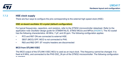

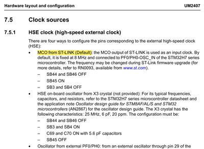

The reason this is happening is that "HSE Bypass" is driven from the incoming clock signal. On the NUCLEO-H723ZG this is an 8 MHz signal driven by the HSE within the ST-LINK. So it will have the same jitter as HSI.
The user manual goes into some detail about this.
This is in contrast to the NUCLEO-N657X0-Q where the default HSE is the onboard crystal. Again, the user manual covers this:

Hard to believe really. Double check the clock configuration of your project. The PWM output frequency stability & jitter should be and ARE exactly the same as MCU clock input parameters. On most of Nucleo boards (excluding STM32L series ones) it is possible (but not obligatory) to use 8 MHz clock from ST-Link (8.33 MHz option is available but not default on Nucleos with ST-Link 3). On newer ones (C0, H5, ...) onboard HSE oscillator or generator is included.
If you use HSE as input clock, the only jitter and instability you may encounter originates from PLL and should be neglectable & hard to measure.
@TDK: AFAIK, ST-Link output clock is generated by its crystal-driven HSE, so it should be pretty good.

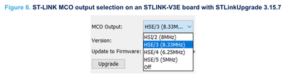

@gbm On ST-Link V2 chips where the st-link uses a 8 MHz crystal, you would be correct. On the STLINK-V3E (which the NUCLEO-H723ZG has), the ST-Link chip uses a 25 MHz crystal and can't do this. There are a variety of outputs, but the default (8 MHz) is derived from the HSI.

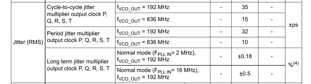

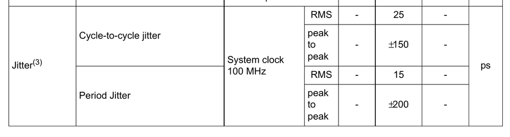

see ds also, about the jitter to expect from the PLL : here for H7Sxx
or for F411 ...little bit worse :

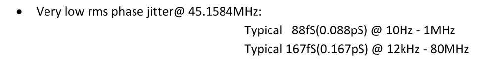

and see the jitter of a low noise oscillator (i use it for my audio player): AS318 b
