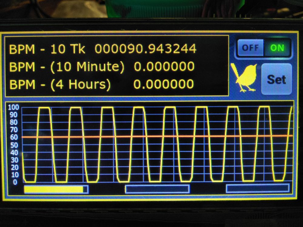

I am using a text area to display a precision timer output (double) and need 8 decimal places of precision. Thye best I can get is six:
I have a wildcard buffer of twenty and the following code:

Unicode::snprintfFloat(textBPM_10TicksBuffer, TEXTBPM_10TICKS_SIZE, "%03.8f", tData.tenTickBPM);
The best I get is 90.056274 which is six decimal places.
If I change the code to:
Unicode::snprintfFloat(textBPM_10TicksBuffer, TEXTBPM_10TICKS_SIZE, "%03.12f", tData.tenTickBPM);
I get the same precision:
89.988746.
Which is 6 decimal places.
What am I doing wrong?

"%03.12f"
The number preceding the dot ("3" in this case) is not a number of digits before the decimal separator. It's a minimum number of total characters (not digits!) printed for the particular field.
https://en.cppreference.com/w/c/io/fprintf
Yes,
I know that is what it is supposed to be as per the documentation:
https://support.touchgfx.com/docs/api/classes/classtouchgfx_1_1_unicode/#snprintffloat
Viz:
\%[flags][width][.precision]f
If I write
"%011.8f"
0089.988723
If I try:
"%013.8f"
I get:
000089.988723
The floating point number being displayed is: 89.98872391054008 using STM32CubeIDE Live Watch variable.
It simply does not work like the normal C /C++ printf or the Touchgfx snprintfloat documentation.
I have checked the layout an I am not truncating it in the display.
0693W000008yM76QAE.jpgIn this case the reading was 90.943244
The textArea extends out to the yellow border near the wren's tail so there is plenty of room for more another two digits.
