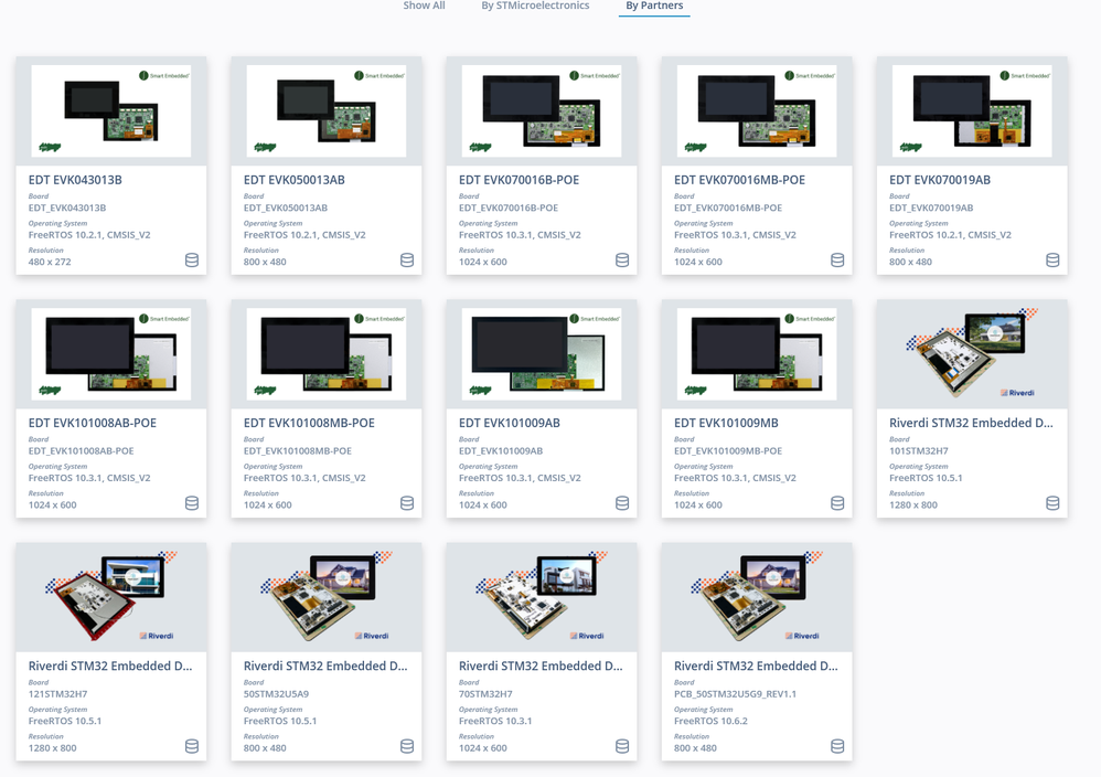

If you are looking for third party displays with out of the box support, there are these partner displays with integrated MCU:

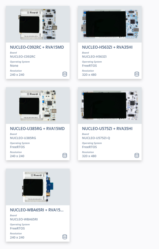

If you want a display and a separate Nucleo board, these options are available, although they are smaller than the requirements you listed:

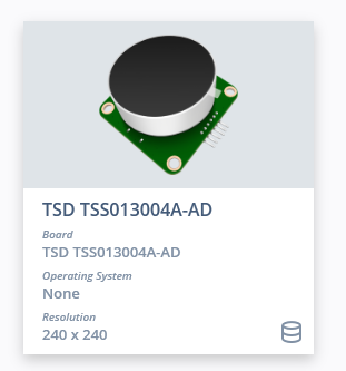

Finally, there is support for a knob style display from Team Source Display:
