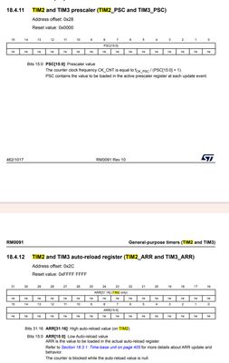

It is not possible to set a 15 minute timer on a 16-bit timer with a timer tick rate of 48 MHz. You can use chained timers instead.
Hello again,
You can also use the TIMER 2 wish has 32-bits ARR register.
Best regards.
II

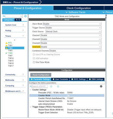

Nico3
Senior
please suggest the settings. I set prescaler and ARR but not sure about other setting. i just need to use as basic timer.
 Hi, your parameters will work fine if you keep them as shown in the picture.
Best regards.
