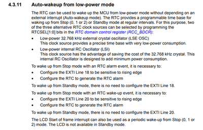

I find that I need to enable the APB clock to the RTC during sleep (i.e. by setting the RTCAPBSMEN bit in the RCC APBSMENR1 register) otherwise my code won’t wake after calling __WFI(); is the AI explanation below correct? The AI also says it’s EXTI line 20, whereas the manual (RM0503 Rev. 2) indicates RTC on 28 and TAMP on 29, so I assume it’s wrong about that?

Hello @kswST,
The RTC requires the APB clock to be enabled to distribute the PCLK and handle interrupts in the synchronous domain, you can do this using the macro __HAL_RCC_RTCAPB_CLKAM_ENABLE()
for the dedicated EXTI line, you have to check the RM, AI's reference is incorrect!

Thanks – I can’t find the macro __HAL_RCC_RTCAPB_CLKAM_ENABLE() – which file is it contained in for the STM32U031 library?
But regardless of that, my problem is that I find my STM32U031 (and also an STM32u083 I tried) will only wake if the APB clock is enabled during sleep (by setting the RTCAPBSMEN) so the AI response seems reasonable to me, i.e. the wakeup isn’t getting through to the relevent blocks (presumably the EXTI) unless the APB clock to the RTC is enabled during sleep. I can live with this, although I would like to minimise current consumption by turning off all unneccesary clock in sleep.
