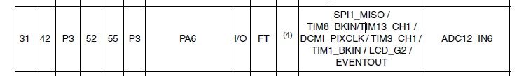

The biggest one would seem to be your random association of PA6 with TIM10_CH1, you can't just make this stuff up, you have limited options as described in the Data Sheet/Manual.

Now i use the timer13 ch1.
I would like generate an interrupt after a number  N of external pulse in the pin PA6  with the TIM13.
Can you help me with a example??
What should I use? The timer input capture?Configure the timer with TIM_TIxExternalClockConfig???
Thank's
Posted on August 07, 2014 at 18:30
Pretty sure that TIM13 can't use an external clock source.
