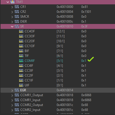

Dear JW,
Thanks for the reply, I had tried some debugging yesterday. But I'm relatively new to HAL and interrupts especially, I've been trying to get a better hang of it and thought I understood the process more clearly.
I will detail here my debugging process, I would appreciate if someone more knowledgeable could point me to mistakes and next steps if any are available.
First thing I did was to also enable the update event for TIM1 to see if I could get any interrupt going and found for that that I needed the following line in the start. (Before I had only started the PWM channels).
HAL_TIM_Base_Start_IT(&htim1);
This managed to fire the following interrupt.
void TIM1_UP_TIM10_IRQHandler(void)

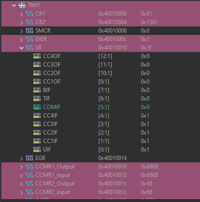

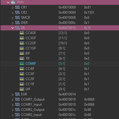

I've also checked the TIM1->SR and the COMIF bits, before and after event generation.
Before Event GenerationBefore Event Generation
After Event GenerationAfter Event Generation
After The Clear FlagAfter The Clear Flag
Satisfied that the COM interrupt flag is set and I can manually clear it I changed the main loop back to

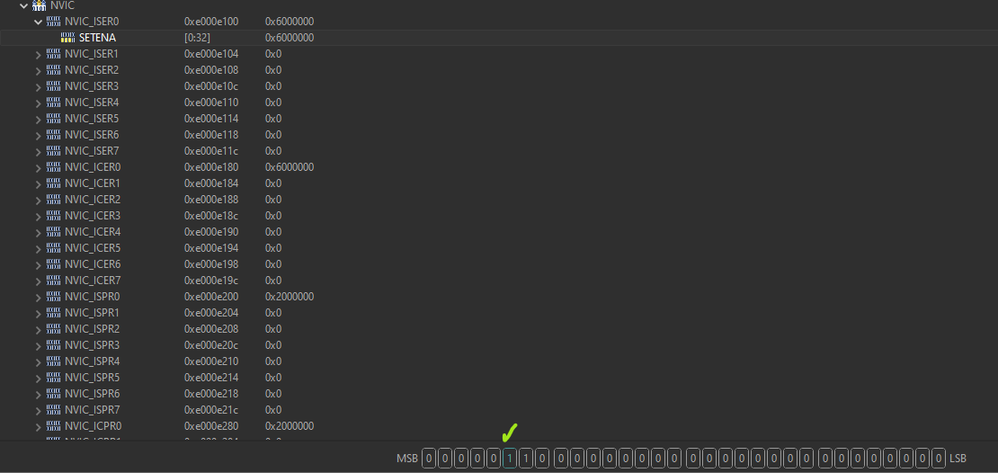

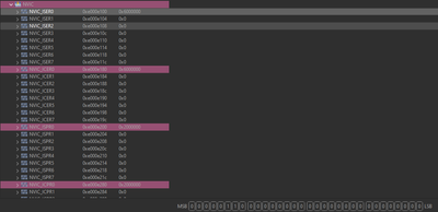

I'd like to add the contents of the NVIC registers, I've been trying to read through RM0090 to find the ISRx registers but have not been able to locate that. Thus I have a hard time knowing whether the interrupt enable lines are actually configuring things correctly. I attach here a picture of the registers, If anyone knows what page in RM0090 it is or in some other document I'd appreciate that.
NVIC ISERxNVIC ISERx
I also attach here the vector table in the start up, line 50 below has the interrupt in question.

I've looked even deeper into it, turns out this IRQn is 26, defined in IRQn_Type enum.
  TIM1_TRG_COM_TIM11_IRQn     = 26,     /*!< TIM1 Trigger and Commutation Interrupt and TIM11 global interrupt */
The HAL_NVIC_EnableIRQ, calls NVIC_EnableIRQ with that number, which is a macro for
__STATIC_INLINE void __NVIC_EnableIRQ(IRQn_Type IRQn)
  if ((int32_t)(IRQn) >= 0)
    __COMPILER_BARRIER();
    NVIC->ISER[(((uint32_t)IRQn) >> 5UL)] = (uint32_t)(1UL << (((uint32_t)IRQn) & 0x1FUL));
Then here if I am not mistaking, we divide the number by 2^5 = 32, to find which ISERx register 32 bit words this number belongs to 26/32 = 0 so ISER0. Then we extract the lower 5 bits of 26 which is 26. And put one into bit 27 (if counting from bit 0).
That then corresponds to the following highlighted bit
ISER0 bit 27 setISER0 bit 27 set
I don't know how to see if there is some mismatch in the NVIC controller or something for why this is not firing. I hope I have provided enough information for anyone that would be able to help me :)
waclawek.jan
In your timer screenshots, TIMx_DIER=0x1, i.e. only UIE is set, not the commutation interrupt enable bit.
I don't use Cube/HAL.
Thank you very much JW, this was absolutely that problem. I would have thought that either it would be enabled through CubeIDE or through the
HAL_TIMEx_ConfigCommutEvent(&htim1, TIM_TS_NONE, TIM_COMMUTATION_SOFTWARE);
I was unaware of this register (DIER) DMA/Interrupt Enable Register. For anyone else that might stumble on a similar problem adding the second line below, enables the com interrupt for TIM1.
htim1.Instance->DIER |= TIM_DIER_COMIE; // THIS LINE!
 Again thank you very kindly for the assistance JW, I was losing my hair :grinning_face_with_sweat:
But that has me wondering if there is some HAL function call missing, or if there is something wrong in the IDE pipeline. Because the UIE bit is set but not this one considering similar IDE setup.
